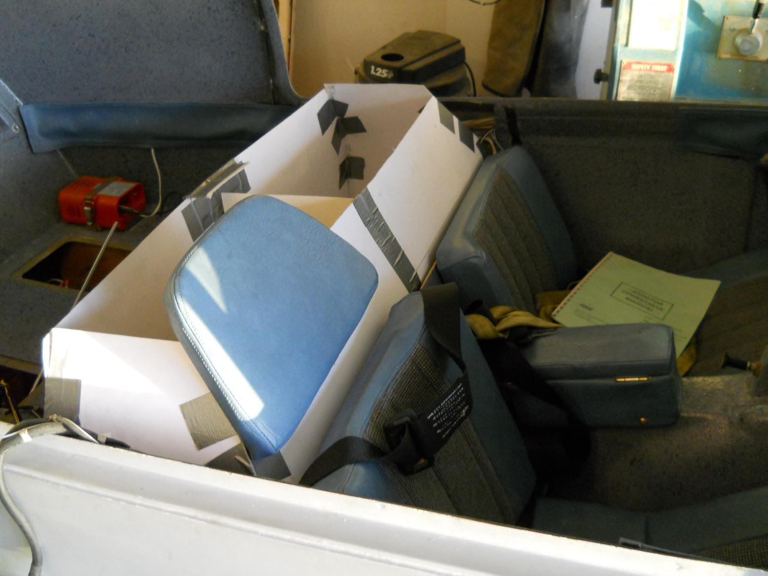

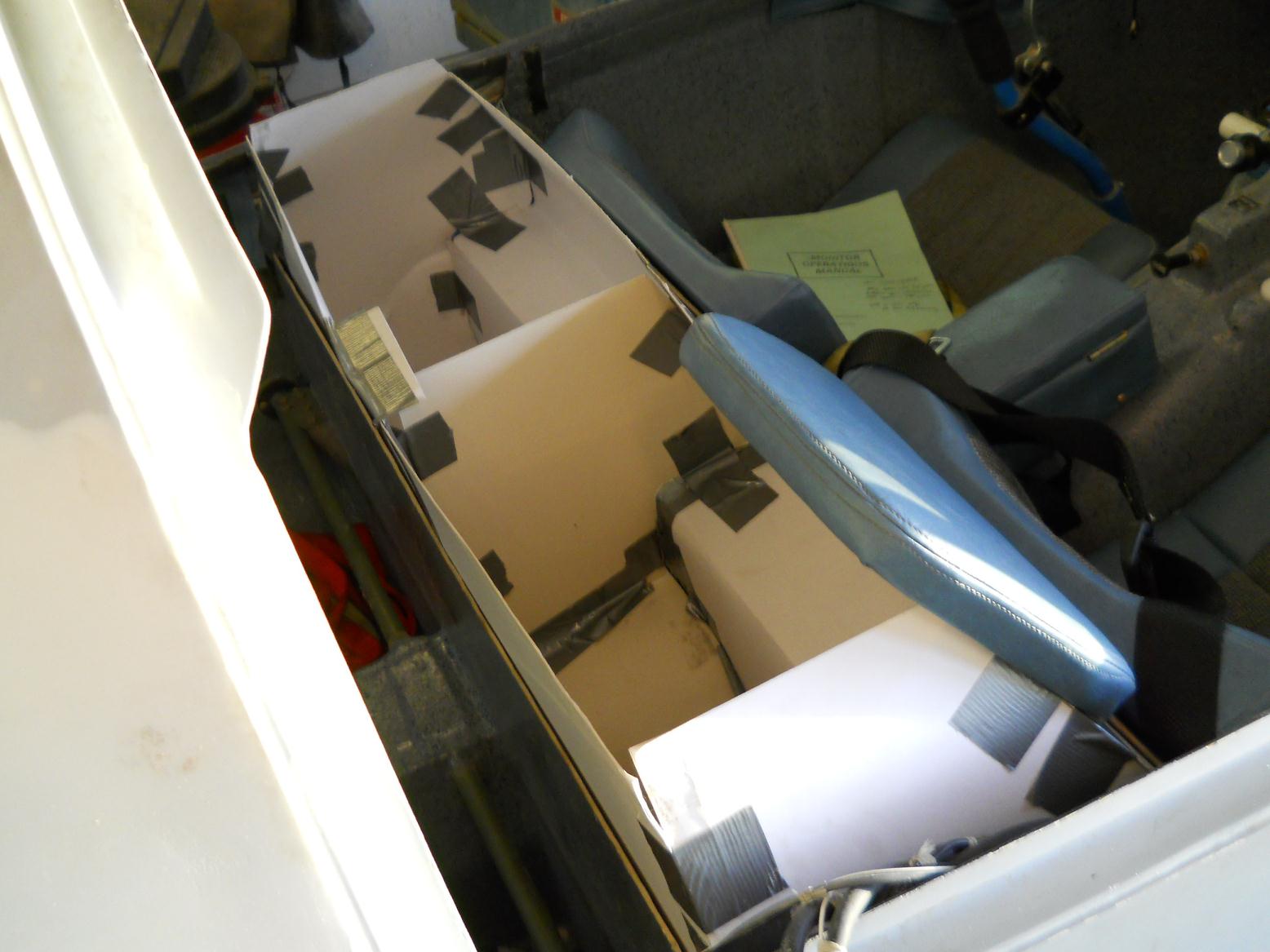

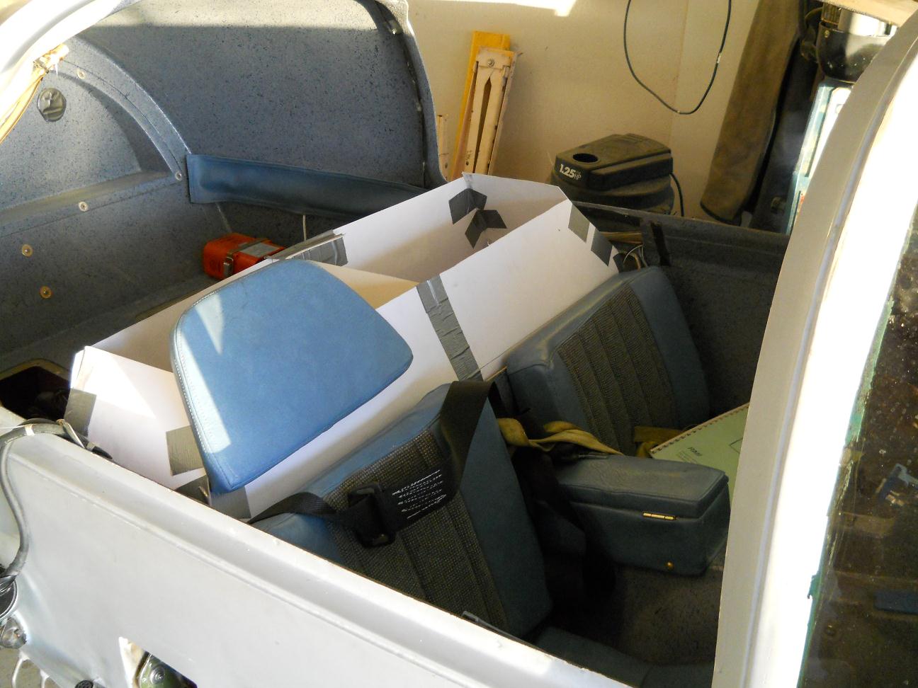

hagargs(at)earthlink.net
PostPosted: Wed Nov 13, 2013 8:19 pm    Post subject: XS Fuel Tank Reply with quote
Bill:
I had been in the same tank situation as you. However the issue occurred at about 20 hours just as all the flight testing had been completed. The plane was down for maintenance and I drained the gas out of the tank as it was getting stale. Upon filling some time later gasoline started coming out of the plane almost as fast as it was being put in. Having the tank dry caused it to shrink back from its fuel expanded shape . The tank pulled away from one of the fiberglass mounts causing a good sized tear.
I was pretty soured at the situation as the tank is really the first thing put into the cockpit . After doing some research I had found out there are kit car companies out there that offer rotationally molded polyethelyne tanks. The sell them with one caveat. They will absolutely not warrantee them if they are fiberglassed into the car as instructed to in the Europa. My soured disposition turned to one of disgust. That along with changed priorities and financial situation has led to the plane being grounded for I don’t know how many years. The serial # is 143 so count from there. She gets pushed out in the driveway about every 10 weeks or so and the 914 is run for an hour cycling up and down at different RPM levels to prevent “engine atrophy”.
However I did spend some time at getting a new tank designed for aluminum construction and have a few thoughts, suggestions and many photos to provide. I am a mechanical engineer in an industrial facility and am presented with the opportunity to perform many design and repair/rework efforts that are similar to this .
The first issue is the fact that the tank does not come out whole if you want to leave the joggles that form your door window sills in place. I did not want to mess with these as they perform a major stiffening function in the fuselage top. The tank was cut up to get it out after taking the backrest top off. I do have a replacement polyethylene tank and attempted to place it in after making some spreader bars to perhaps push the fuselage out to allow the tank to drop back in. This was not successful as the it was putting too much stress on the structure for my liking. So it was on with designing an aluminum tank as was my original plan.
Now if you have some time to spend and are willing to look at things in a different way I believe you can come up with something much better than the original design. I had seen the aluminum tank design and how it closely approximates the original. I was going to approach it the same way. I faced some trepidation seeing all the welding and pockets and curves in the front section of the tank to clear the aileron mechanism spar etc and still keep an acceptable volume in the tank.
The original tank is 41” wide, the replacement unit would have to be about 2.5” narrower in order to make it an easy re-installation. This is conservative .When ever I design one thing to fit in another and one of the pieces is a big project as far as time an money goes I have never been sorry in 20 years by making it fit loose instead of tight. Its a lot easier to take up space than it is to make new space. However I would be “losing volume” . I thought the tank was too small to begin with. (I did have the extended range tank, that has a new home in Erich Trombley’s bird). However with the top of the back rest off and looking at the stock tank , it became readily apparent that there was an opportunity to be had. The largest horizontal cross section of the tank is at the top. This will give the greatest incremental increase in fuel capacity for each incremental increase in height. Using a conservative measurement of 38” span wise and 11” wide you get about 1.75 gallons for each inch in height. There are also other opportunities to be had.
Now with this thought in mind I saw that the complications with forming the aluminum and shaping the replacement like the original with tight clearances down low are slowly fading away. Design for excess clearance in order to make mounting and access for maintenance easier and make up the lost volume up high. The CG will also favor the front (the good direction). Without the complicated shapes the whole tank may be able to be made with 5 to 7 larger pieces with less welding required (see photos with patterns). My tank pattern has much more clearance around the spar and aileron bell cranks. The central tunnel is much larger. You can get your hands inside from the access panels. I had thought about having all the fuel fittings come out in the tunnel pointing in to the center instead of coming out the front of the tank to make re plumbing it easier.
The tank comes up in height several inches, but also it is built up to form the mounting surface for the back rest pads as shown. The space between the 2 rests has been omitted and it is one continuous cross section from left to right. With this tank I would also get rid of the “fuel filler cobra”. Note the cap on the aluminum fuel cell in the photos. A cap like this would go on the right side of the right head rest area just inside the door. You open the door to refuel. This is what is done when the extended range tank is filled anyway. The large opening makes filling easy and does not present the venting issues with the cobra. My rough calculations give the tank about 3~4 gals greater fuel capacity than original.
You will also be able to customize your reserve side to your liking as you will need to put a baffle in for stiffening. A suggestion would be to make the baffle all the way to the top and add perforations on the top side to dampen fuel sloshing from left to right when banking. When re-plumbing the line to the reserve side adding a “T” to it and going back to the primary side will allow you to use the fuel left in the main when you switched to the reserve. You will have to put a check valve in to keep from drawing on the reserve during normal operation.

Bill:
Of course you need to design in all the fittings. vents, return , fuel gauge etc. Put in a ball valve for draining and an extra fitting for aux fuel hook up.
Caveats:
I have not built up the tank , but use these thoughts and photos as a guide of sorts to start the effort. This is how I would do it. Kim Prout inspected my original build and had no qualms with my workmanship and techniques. The plane flew hands off and was very stable. At this time there are no plans to ever fly it again. I may decide to part it out when I get tired of pushing it in and out of the garage.
It looks like I can only attach 3 photos at a time so I will send additional reply submissions
