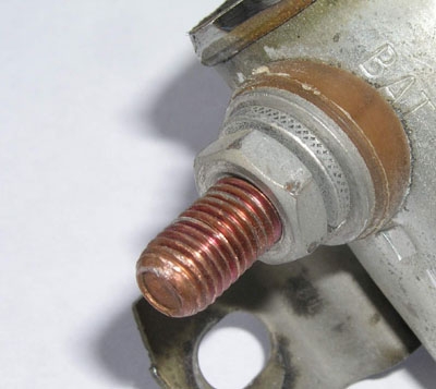

Note that he appears to be using something (on the left) that looks to me like a battery contactor in lieu of a starter contactor. The master contactor is the red "384" series cube on the right.
I am not comfortable with the notion of tying
4AWG wires to these 70A plastic cube relays . . .
Consider the terminals on a 70-series contactors
. . . or any other "contactor". They are mechanically
robust.
[img]cid:.0[/img]
The whole idea behind terminal posts on a contactor
is to provide rigidity . . . wiring induced bending
and torque moments do not move the terminal . . .
hence they do not affect contact alignment inside
the contactor.
Terminals on the plastic cube relays are simply
held in place by virtue of the housing molded
around them. I think if I were going to incorporate
one of the 70A cubes into a system, I would wire
with no greater than 6AWG and use welding cable
at that (soft and flexible).
The reasoning driving substitution of the plastic
cube as a battery relay seems to be rooted in
power consumption . . .
The 'savings' between a cube (180mA) and a
70-series (700mA) coil current is only about
1/2 amps.
Are you sure you NEED to save that 1/2A for
other tasks? If 1/2A has so much influence
on your load analysis, then perhaps you're
proposed sources/loads are not practical.
I suggest you consider finishing up the load
analysis task before you commit to incorporation
of an extra-ordinary substitution for a battery
contactor with a known service history.

Thanks for your comments Bob. In effect I had not considered the mechanical suitability. I generally tend to like to do things with the simplest most commonly available automotive type parts but maybe this is one case where it's simply not a good idea.
