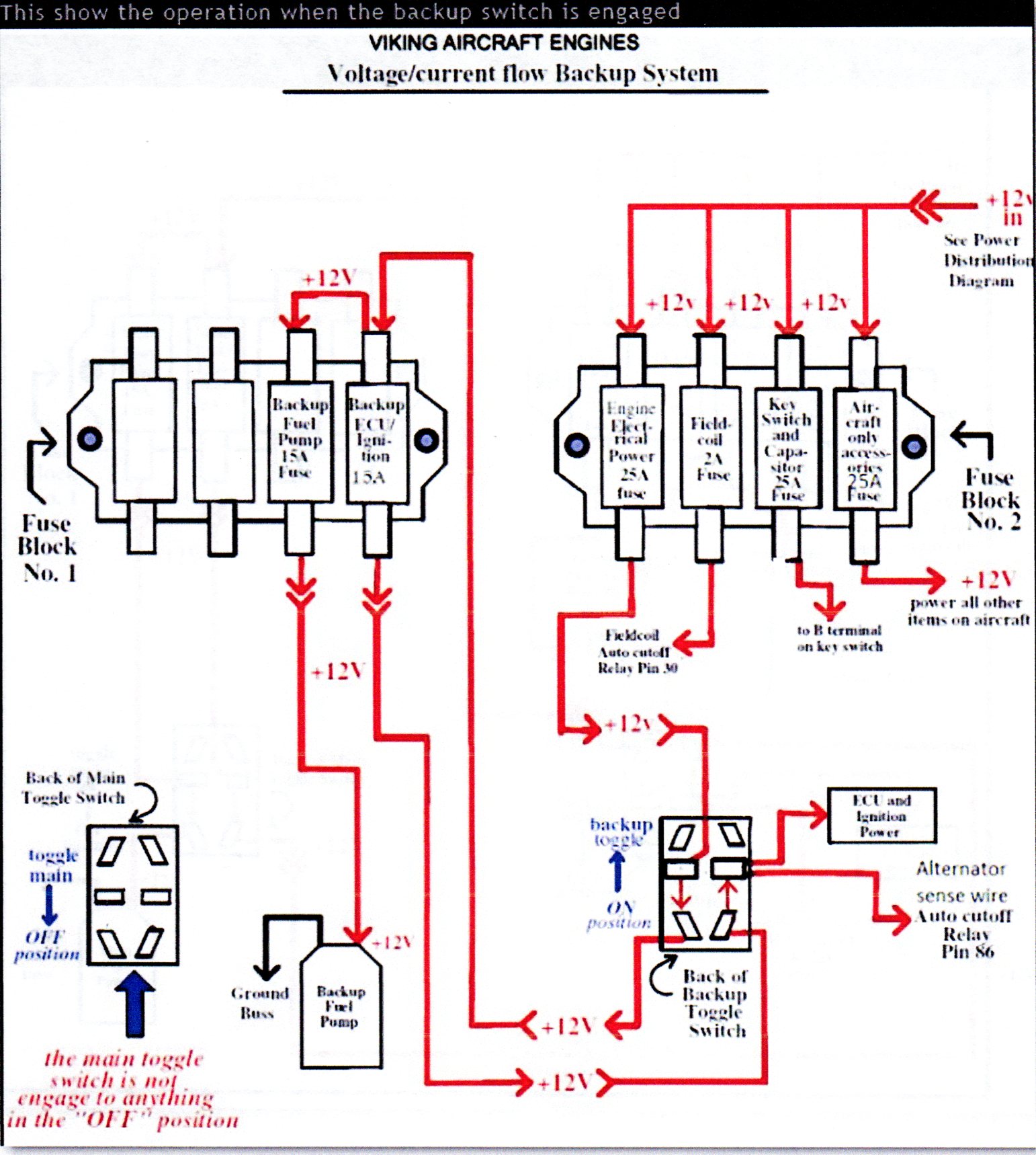

Hi Robert,
I know you have concerns about the Viking engine’s electrical system. But I purchased a Zenith aircraft with this engine and want to make the plane as safe as I can. The engine is an “aircraftized” Honda Fit with fuel injection. Since the engine will stop is a fuel pump fails Jan Eggenfeller specified duel redundant fuel pumps and the ability to switch pumps. However, there are no previsions for a duel battery circuit or a way to isolate the battery in case of an alternator fault.
I would like to install two batteries that are both charged from the 55-Amp alternator and also be able to select the battery that powers the plane’s electricals and to isolate the batteries by disconnecting a faulty alternator in flight. I previously built a plane with a Rotax 912 using your wiring diagram, (after attending your great seminar). The Rotax diagram had battery isolation capabilities and was wondering of any of your wiring diagrams describe how to do this for my Viking engine or, if not, can you explain how I can do this properly or at least specify the diodes I need to install in the attached diagram.
Thank you for your help,
Les Goldner
the plane as safe as I can. The engine is an "aircraftized" Honda Fit

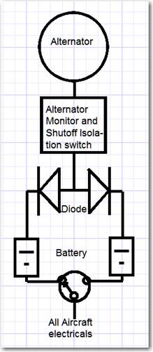

There was some discussions and analysis conducted on
the aviation special interest groups about 18 years
ago concerning the use of diode isolation (ala RV
and boat batteries) for dual batteries on airplanes.
http://tinyurl.com/oss5t4u
the plane's electricals and to isolate the batteries by disconnecting
attached diagram.

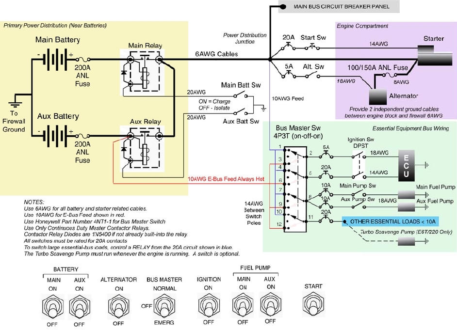

We've had some discussions here recently on
electrical system reliability for the electrically
dependent engine . . . exploring the notion
that a well maintained, single battery/alternator
system has a very low failure rate on a par with
other components that might cause engine failure.
A new Z-figure . . .
http://tinyurl.com/kbn6bys
. . . is in it's 5th refinement iteration
and I'm pretty confident that it's final configuration
will be suited to your installation as well without
suffering the weight and cost of ownership penalties
for carrying two batteries . . . just to address
one of many failure modes.

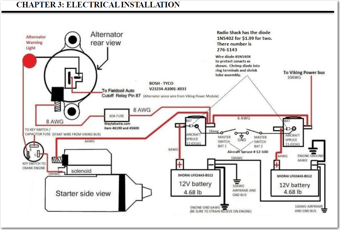

Are you sure that is a picture of an Eggenfellner installation? It
doesn't look like any Eggenfellner setups that I've seen, but it does
resemble an older NSI setup that I saw at OSH or Sun-n-Fun some years back.
At any rate, it is certainly not typical of what is being installed to
support Subaru engines (Eggenfellner or otherwise) these days. The
Aeroelectric Connection is often used as a reference on the Subaru
lists, but if you want to see the last recommended electrical design
that came from Eggenfellner before they went out of business, you can
download the installation guide from:
http://subenews.deej.net/wiki/index.php/EggH6
Click on the "Eggenfellner Engine Installation Guide" (top link under
the under the Howto Guides section), and go to page 45, and page 51 has
the electrical schematic.
Please note this is not an endorsement, just an informational posting. Smile

PostPosted: Fri Jan 03, 2014 10:13 am    Post subject: Viking engine duel battery setup Reply with quote
At 11:28 AM 1/3/2014, you wrote:
It should be noted that the primary reason for such circuitry is to
prevent paralleling the two independent batteries thru the charging system.
Why would one want to do that?
PostPosted: Fri Jan 03, 2014 10:15 am    Post subject: Viking engine duel battery setup Reply with quote
Actually, I'm not. I saw the airplane on display
at an airport where I was giving a weekend seminar.
I snapped the picture to use in the seminar as an
example of an installation that would benefit from
some judicious review.
to support Subaru engines (Eggenfellner or otherwise) these days. The
Thanks for the heads-up! With all due respect
to Jan's work, my apologies for any errors of
attribution.
has the electrical schematic.

You asked to see the Viking wiring diagrams so I attached two diagrams Jan
Eggenfeller provided for the Viking engine. The diagram named "Backup
System" is a very nice looking module provided with the Viking engine for
redundancy to control two fuel pumps (I think it also controls a duel ECUs)
in case one fails. The other diagram is more relevant to my questions to you
about having two batteries. It shows recommended power provisions,
including a second battery. I would appreciate your comments about employing
this two-battery arrangement?

PostPosted: Fri Jan 03, 2014 11:50 am    Post subject: Viking engine duel battery setup Reply with quote
for many of the same reasons that (I imagine) you put a "buss tie" contactor in the Z-14 drawings.
It should be noted that the primary reason for such circuitry is to prevent paralleling the two independent batteries thru the charging system.
Why would one want to do that? AeroElectric wwtarget="_blank" href="http://www.buildersbooks.com/">www.buildersbooks.bsp; * My Pilot Store

PostPosted: Sat Jan 04, 2014 5:15 am    Post subject: Viking engine duel battery setup Reply with quote
But what might those reasons be? In other words, we
add a component to a system to effect some desired
functionality that figures into the overall performance,
failure tolerance and risks.
If diodes were incorporated in the manner suggested
to feed the two batteries, how would we expect these
to operate and for what purpose?
I'm not trying to be obtuse here my friend. I
AM encouraging all of my readers to understand
the application of every component they choose
to add to their system. Suppose I offered a description
for the buss-tie contactor like, "This contactor
offers pilot control of the phramistat to prevent
inadvertent operation of the whatsadozit and
potential damage to the dingusfuzzy."
The inquiring builder would probably want some
detailed expansion on that statement . . . un-
fortunately, others will assume the statement
correct and useful based on the reputation
(deserved or otherwise) of the writer.
I encourage yourself and others to KNOW why

Okay, referring to the abbreviated power distribution diagram
from the Viking installation literature, we see two batteries,
both 'protected' buy current limiters and paralleled onto
the system with independent contactors. One of the two batteries
is fitted with an always hot feeder routed to a 4-pole engine power
selection switch.
Years ago, I proposed a similar two-battery system which
could be automated to some degree with what was at that
time called the Aux Battery Management Module.
http://tinyurl.com/l353p5m
http://tinyurl.com/mrxbrtw
Back in those days, the notion was that at least one of
two electronic ignition systems and perhaps a boost pump
could be supported on an independent battery automatically
isolated from the rest of the airplane when an alternator
failure was detected (low voltage).
Let's revisit those notions in light of the Viking installation
documents that speak to a 'requirement' for a second battery
capable of running the engine for a minimum of 30 minutes.
First, how does one KNOW that battery #2 is capable of
meeting that requirement? It has to be sized -AND- maintained
such that the necessary energy available when needed.
Okay, what conditions would FORCE the use of #2 battery?
(a) no doubt the alternator is off line for what ever
reason and (b) and we KNOW that #1 battery is not capable
of carrying the engine + other endurance loads for at least
30 minutes.
Hmmmm . . . if we KNOW that #1 battery is overtaxed for
the task of supplied combined energy needs but that
#1 plus #2 battery WILL rise to the occasion, then what
is the value in having two batteries? Would a single
battery with a KNOWN capacity for the combined loads not
be a simpler, lighter and lower cost choice?
In other words, what combination of conditions pose such
risk that a second battery is needed to mitigate the risk?
Two batteries DOUBLES your battery maintenance expenses
and adds empty weight . . . all intended to mitigate a
rather rare event . . . alternator failure.
This line of reasoning is germane to the discussions
we were having on Fred's Exp-Bus integration which prompted
the crafting of Figure Z-7. It also applies to Les's question
about diodes suitable for battery isolation. Obviously, the
golden solution will include some assessment of loads over and
above those required to run the engine . . . along with
some decisions as to whether you're expecting to keep the panel all lit
up . . . or have crafted a plan-B that matches your skills
and confidence levels for getting down with a bare minimum
of panel equipment combined perhaps with flight bag back-up
hardware.
If Figure Z-7 were substituted for the figure above, are
there any unforeseen risks? Comments on the Viking drawing,
Figure Z-7 and perceptions of your individual FMEAs are solicited . . .

Hi All
This is the Eggenfellner Aircraft Engines wiring diagram for a Subaru engine (turbo'd). This where the E6T engine reference comes from.
Cheers
Les
The diodes are to isolate the batteries and their systems from each other. If you simple run a wire from the alternator B terminal to batt A and then to batt B you have paralleled the batteries when your intent was only to charge them. It could be an unintended side-effect. If your mission is to charge the batts then make sure your circuit does that.  If your mission is to parallel the batts then do that, but don't let one just happen as a side effect of the other.
It is difficult to control the assumptions made by readers.
a part is included and UNDERSTAND what useful
  things it will do for you. Hence my question
as to any value you perceive for having those
diodes in place as suggested.
I know why - been there done that - and repaired the damage from some of those uninnd Get Some AWESOME FREE rget="_blank" href="http://www.aeroelectric.com/">www.aeroelectric.comwww.mypilots; &nb========================
PostPosted: Sun Jan 05, 2014 12:51 pm    Post subject: Viking engine duel battery setup Reply with quote
Agreed. I can deduce no practical purpose for
these diodes. As long as the alternator is
operating normally, it charges both batteries.
If alternator fails, you get a low-voltage
warning light and you then separate the
batteries onto their respective tasks.
In other words, the system can service as many
batteries in parallel as dictated by the
alternator-out operating conditions. Simply
parallel through hard contacts for normal ops;
separate for alternator-out ops.
A 'dead' battery will not accept 'charge' from
a fully charged battery. If the batteries are
remarkably different in size, the smaller one
might want to be OFF during cranking.
