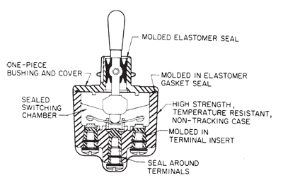

It might well be that a switch with molded
terminal supports . . .
[img]cid:.0[/img]
. . . would not offer the weaknesses of
riveted joints . . . but crimps, threaded
fasteners and internal contacts of the
switch would still be getting 'hammered'.

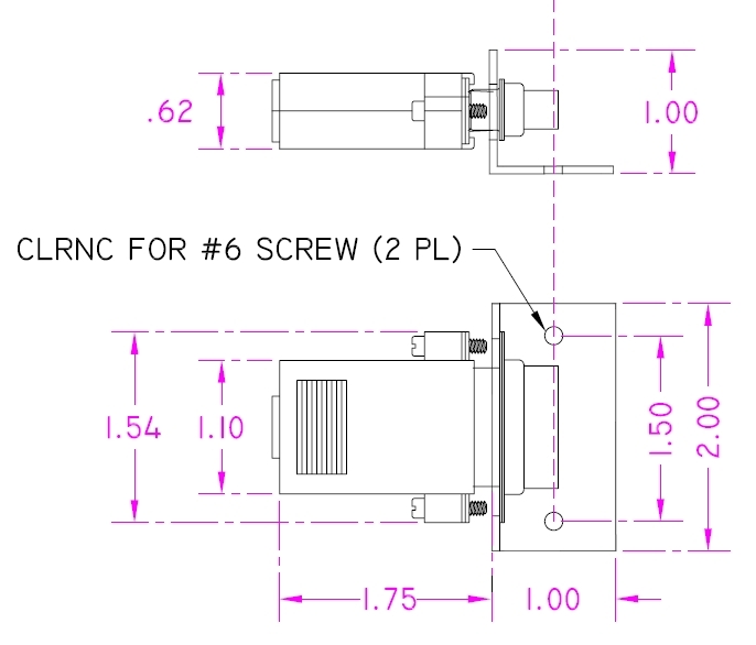

Charlie, do you want to try the solid state
relay? If you do install this relay . . .
[img]cid:7.1.0.9.0.20140122091114.01120aa8(at)aeroelectric.com.0[/img]
. . . it will offer a plug-n-play port through which
we can gather some good numbers when the DAS system
goodies I've ordered get here . . .
Emacs!

to this day. Here's a breakdown of the electron-
pathway through a fast-on-tabbed Carling switch . . .
http://tinyurl.com/qcmyt4e
