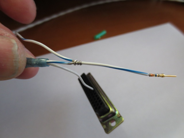

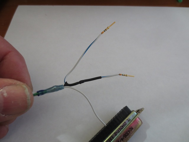

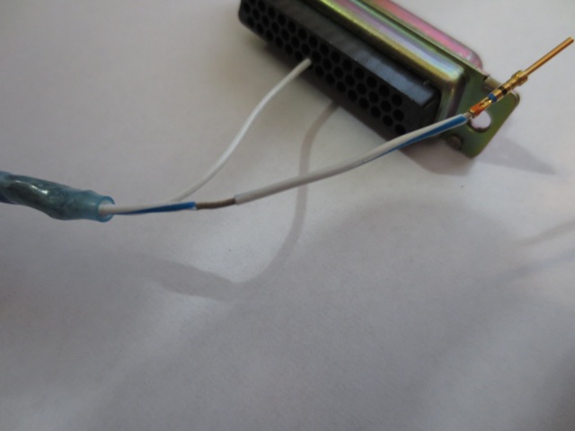

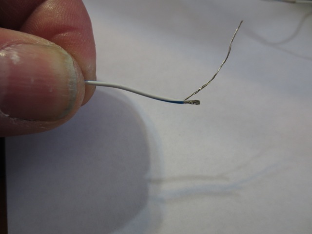

I need to split a shielded wire into 2 pins on on a DSUB. I am sure that what I did would be an acceptable approach but is there a better way?
this is a 2 conductor shielded wire. I have already added a pigtail using a solder sleeve
thanks for the help
I striped off a 1/4 inch strip of insulation about 1 1/2 inches back from the pin

following Bob’s comic book on splicing wires i teased out a couple of strands of the wire to be joined

Wrapped and soldered

added shrink wrap and crimped on the pin

That’s a perfectly acceptable way to do it; I have used that method many times without any problems.

Works good, lasts a long time . . .
