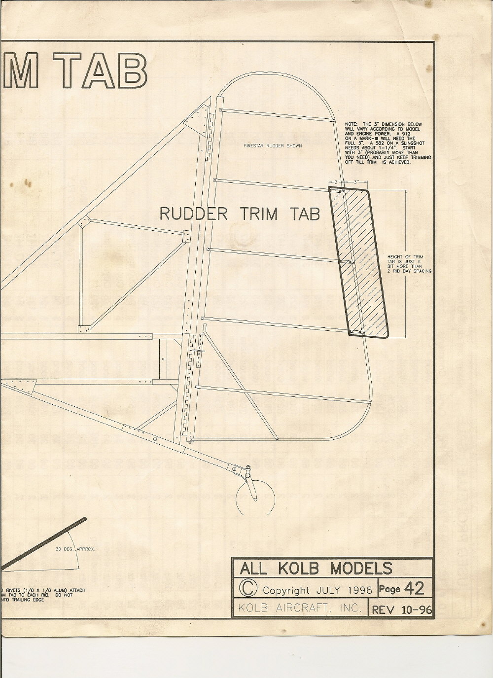

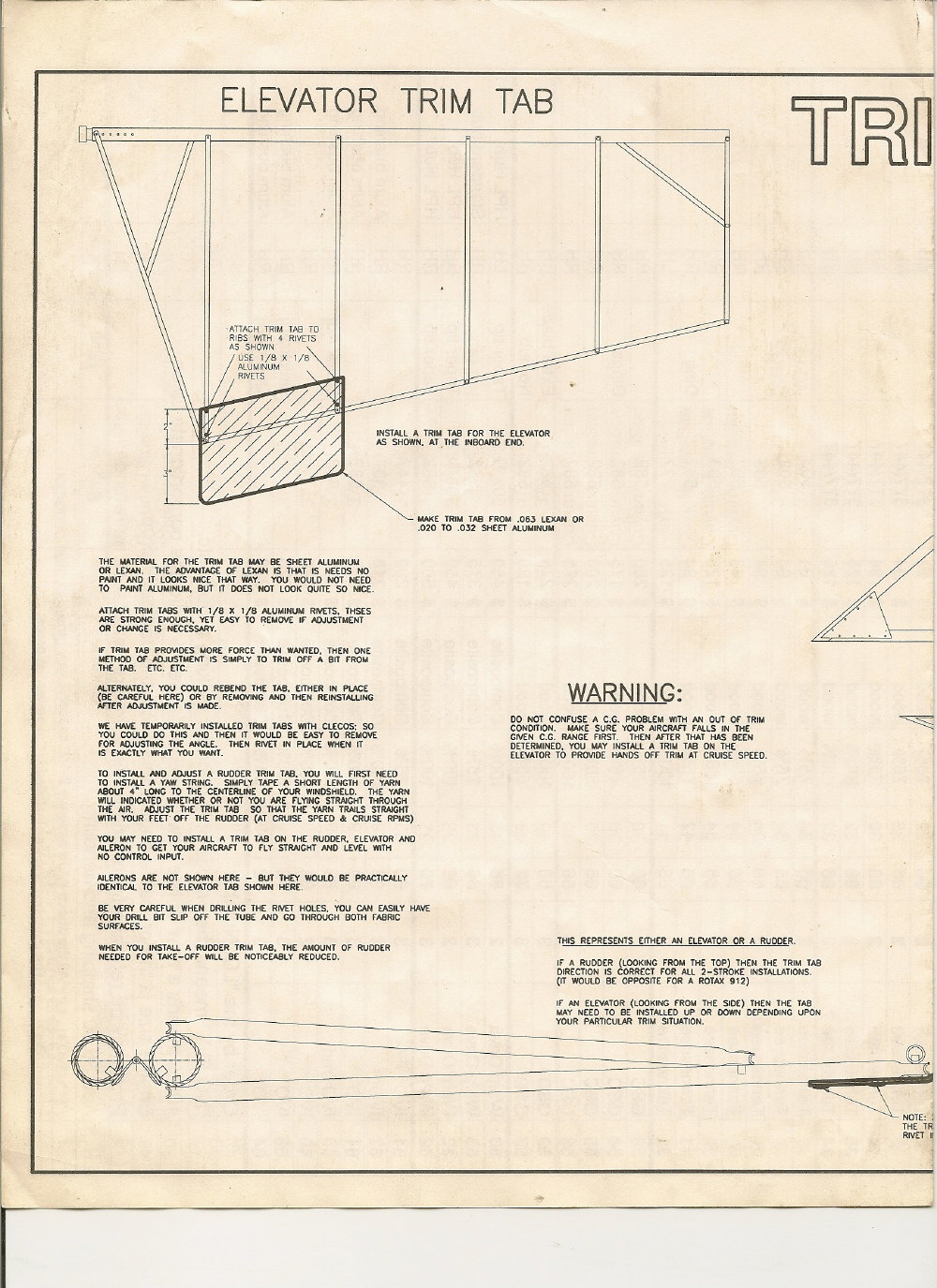

I’m having some steering and control problems with my Xtra. I haven’t flown it yet as I have been dealing with various issues. However, a local IP who has quite a lot of time in tail draggers was kind enough to take it for a test flight today. Dennis Kirby gave him a familiarization ride in his MKIII before the flight. I have had problems with the steering before but thought it was due to loose tail wheel springs which have been adjusted. The last time I did a high speed taxi test I had a difficult time keeping it going straight and ran off the side of the runway. However, during todays attempt the IP had the same issues, " I went around the pattern a couple times with Dennis early this morning and felt comfortable enough to take yours out to try a couple touch and goes, but I couldn't keep yours on the runway during the takeoff roll. Three times off to the left and into the dirt, once it even started rolling uncontrollably left after lift-off. I didn't hit anything and the plane is undamaged but it wasn't for lack of trying. There are serious directional-control issues with the bird.”There is a trim tab on the rudder that is almost at 90 degrees and another on the elevator that is about the same. There is also a trim tab on the right aileron.
It seems that the wheels must be mis-alined which would explain the tracking issue. However, I’m at a loss as the cause of the roll problems, perhaps a wing-incidence problem.
I’m getting really tired of it sitting in the hanger and not in the air!
Any suggestions would be greatly appreciated.

Trim tabs at 90 deg.... I don't understand,, tab deflected that far should stall and not work as needed.. or intended..  what is your toe in / out measurements?  Duo you know how to get accurate measurements?

I would take the trim tabs off of it, or at least bend them in line with the control surface. A trim tab at 90 degrees to the control surface is non-functional, and probably very counterproductive; you have no idea what it might do or what your results might be, but they would probably not be good. I would not consider flying an airplane with a trim tab at 90 degrees. All that tells you is that someone else had major trim problems with it, and didn't know what he was doing as he started trying to fix it, because a trim tab at 90 degrees is nothing but a spoiler. And since it is a spoiler mounted to a movable surface, all bets are off.

That seems to be the consensus of everyone who looks at the tabs, more drag than anything else. As for the toe in/out, no, not yet. Suggestions?

By chance, did those trim tabs get bent to that ridiculous angle during trailering??
Bend them straight with the control surface and see what it feels like, then start adjusting from there.....

Bingo John, but I'd bend them back to 15 to 30 degrees instead of going all the way straight, probably be in the ball park.
Dennis "Skid" RoweMk3, 690L-70, Leechburg, PA
On May 24, 2014, at 3:50 AM, JC Gilpin <j.gilpin(at)bigpond.com (j.gilpin(at)bigpond.com)> wrote:
[quote]By chance, did those trim tabs get bent to that ridiculous angle during trailering??
JG

Posted: Sat May 24, 2014 9:18 pm Post subject: Xtra Control Problems |
Brad, I posted the Kolb drawing for the recommended trim tabs recently. I've attached it to this post, too.What tail wheel do you have?
Rick Girard
On Fri, May 23, 2014 at 9:51 PM, Brad Nation <nationcap(at)comcast.net (nationcap(at)comcast.net)> wrote:
| Quote: | That seems to be the consensus of everyone who looks at the tabs, more drag than anything else.  As for the toe in/out, no, not yet.  Suggestions?
