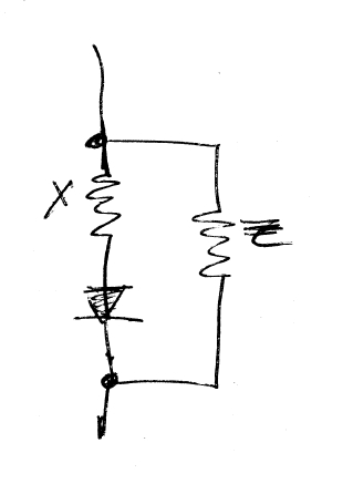

Wrong place for the resistor. There is a resistor X in
series with the LED to bias it up to run on the
14V supply. Resistor Z is used to make the diode/X
string emulate an incandescent bulb. Try 1000 ohms
at Z.
[img]cid:7.1.0.9.0.20140616075849.01f3d938(at)aeroelectric.com.0[/img]
 Filesize:  22.29 KB
 Viewed:  26293 Time(s)
donjohnston
Joined: 13 Dec 2009
Posts: 232
PostPosted: Mon Jun 16, 2014 7:42 am    Post subject: Re: LED Ghosting Reply with quote
at Z.
Well that would make my life a gazillion times easier!
It makes sense too. I'll give it a try.
Thanks!

Sadly, it did not help. It does eliminate the ghosting. But just like when I put the resistor across the LED, it still results in a dimmer LED overall.
PostPosted: Mon Jun 16, 2014 5:02 pm    Post subject: LED Ghosting Reply with quote
dimmer LED overall.
Okay, was this 'output' intended to drive
an incandescent lamp in the first place?
The symptoms you describe suggest that it's
an LED specific output and may have a resistor
already built into the output.

resistor/led array; V2 (voltage across incandescent
lamp); V3 voltage across resistor/led array with anti-
ghosting resistor added.
There's nothing wrong with any of the other LEDs. It's just the one for the engine analyzer. The analyzer is allowing some current through when it's off. With an incandescent bulb, this is not a problem. With an LED, it is. Putting a 1k resistor solves the dimly lit LED but it make the LED dimmer than the rest. So I'm trying to solve two possible problems. 1) Keep the engine analyzer alarm LED from being partially lit when it should be off, and 2) have the LED at the same brightness as the other LEDs.

> Does the LED have a series resistor? If so, what is its value?
Joe
Yes. 390ohm (see attached).\
Perhaps you could use a zener with a voltage just slitely
higher than the open circuit off voltage output. Put that in
series with the LED, to block the small output, and reduce t
he series resistor to bring the brightness up.
Roger

However, the LR-3 is intended to drive lamps with
over 100 mA of operating current. So the schematic
I suggested for one led MIGHT still be good for two
but in any case, the configuration shown for the
V3 measurement is good . . . the 1K resistor is
simply reduced in value until the ghost-light
goes out. So hooking your annunciator to the un-powered
LR-3 should offer a platform for validating the
value of the anti-ghosting resistor.

user9253 wrote:
I suggest that you put a 1.5k resistor across the LED per the engine analyzer people. Then replace the 390 ohm series resistor with a 330 ohm resistor. Or experiment with different values (all less than 390) to get the desired brightness.
Or put a pot in series with the dim LED and turn the pot until the current though the dim LED is equal to the current through one of the other LEDs. Then substitute a fixed resistor for the pot.
40 years ago I could have calculated the resistor value. Now trial and error is easier. Smile
Joe
I tried that. I ended up with no series resistor and it was still dimmer than the others... At least at the bottom end. At the top end they seemed brighter.
