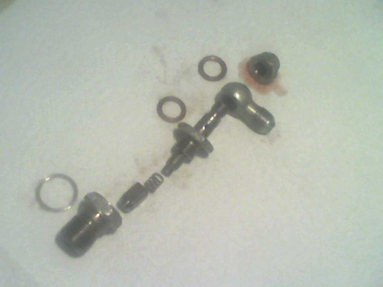

Another thing I found when I was having issues was that the air was leaking out of the front selector valve but it was due to a bad rear valve......

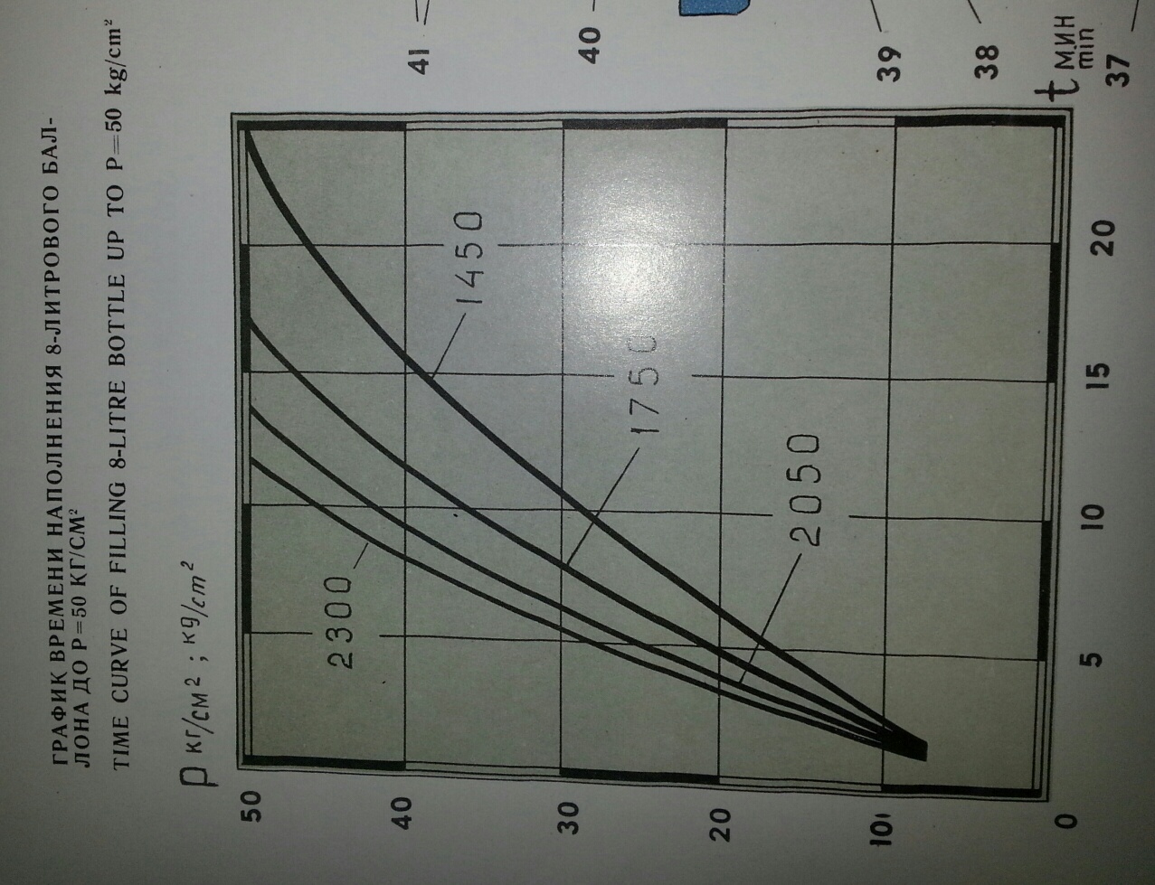

PostPosted: Sun Jul 06, 2014 9:37 pm    Post subject: Re: Pressure Problem Reply with quote
Hi
I see mention of the compressor building pressure a bit while taxing?
I also saw in the manual that the charge rate is approx 8litres in 30 minutes at 60%.
At what percentage do the compressor start charging and will it charge faster if the RPM is higher?
We have a problem where the compressor don't seem to charge but I don't know if it will only visibly charge enough while in the air or also on the ground. ie. 50% for how many minutes, etc?
There is no audible hissing sounds with gear down.
Paul
Rob Rowe
Posts: 124
Location: Berkshire, UK
PostPosted: Mon Jul 07, 2014 8:00 pm    Post subject: Re: Pressure Problem Reply with quote
Paul,
The attached graph image is from the AK50 schematic poster that may be of some help to you.
Note :
- the graph is to fill an 8 litre bottle, on a YAK-52 the main bottle is 11 litres
- the RPM quoted "may" be related to the compressor speed, which is 0.9 engine speed (I think)
If you've no obvious leak then it's worth a quick check of the compressor outlet non-return valve. If this is leaking then the charge performance gets reduced and as the compressor cools post shutdown air trapped in the pipes & "snot pot" downstream of the pressure regulator valve gets bled back into the engine crank case and out the breather vent.
Easy way to find out is to check whether the "snot" valve loses back pressure soon after shutting down. Also try putting a rubber glove over the breather vent just after shutdown, if it starts to inflate then that's where your air has gone!
Now this may not be your problem, but at least it's an easy way to eliminate one candidate.
Hope this helps.

Most folks either never or very rarely remove the output check valve on the compressor to disassemble and clean it. The little "piston" gets so carboned up that it is stuck closed. It is suppose to open and close with each output stroke of the compressor.
It might be a good idea to remove it, disassemble it, clean it and reinstall with new crush washers. The attached photo is not the best. But it does show the compressor output check valve disassembled. The "piston" is next to the little spring on the left. The spring fits inside the piston and the piston inside the assembly just to the left of it. The end of the unit (left side) fits inside the compressor. The end of the little "piston" is about the size of a pencil eraser.

Paul,
Note :
Hope this helps.
Brgds, Rob R
