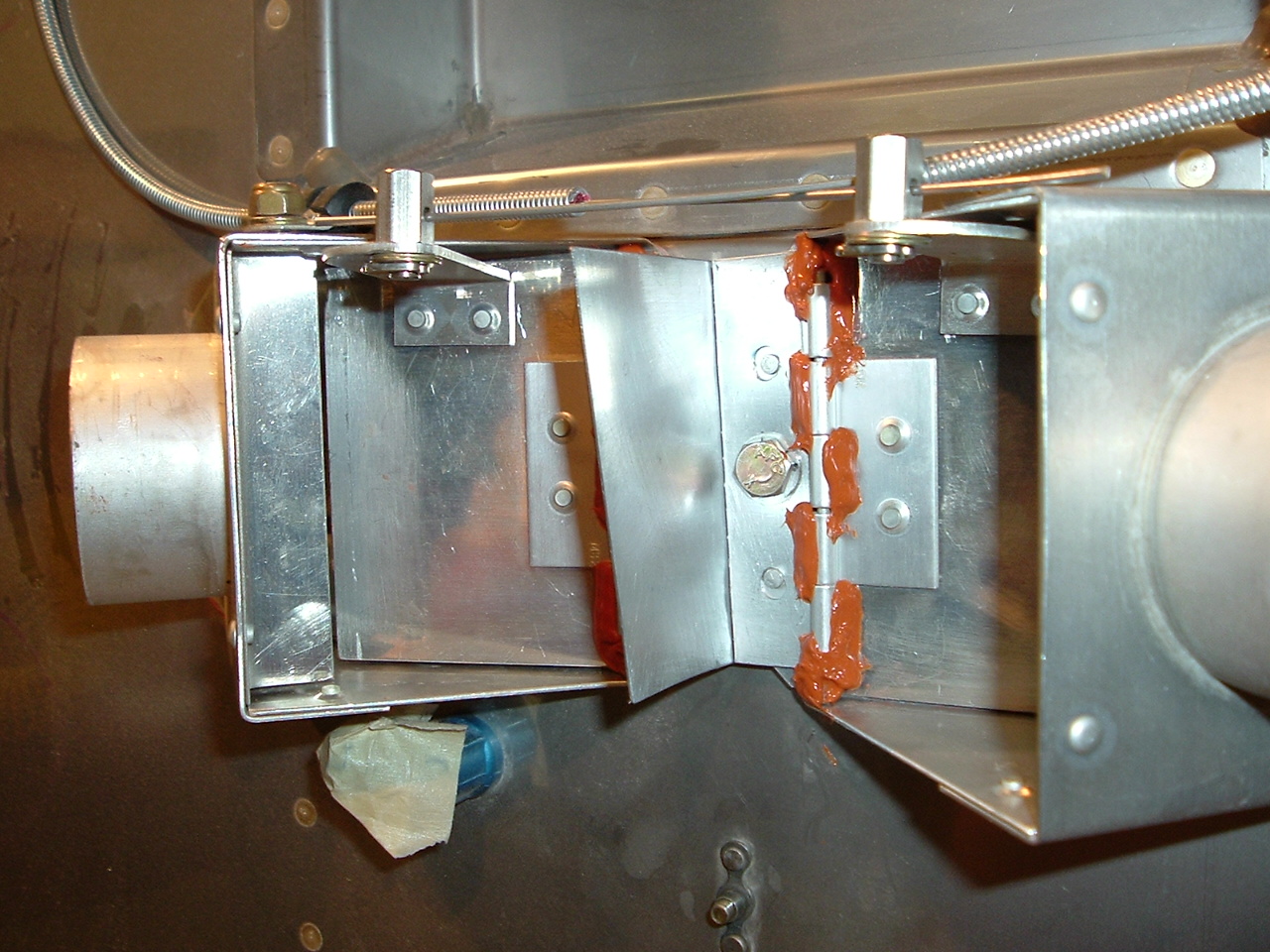

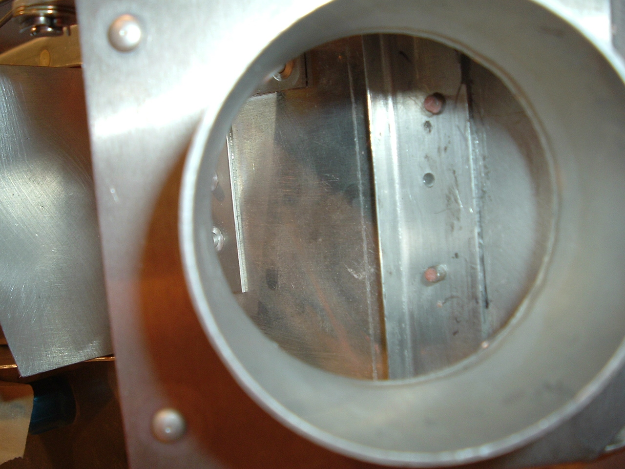

I wanted to pass on a suggestion for those looking to keep their RV 10 TUNNEL cool. Take your Black & Decker Wet vac and hook the hose to the blower/discharge air. Then place the hose over one of the heat vents on the firewall simulating hot air blowing into the cabin. Close the vents and see if air is still entering the cabin with the vents shut and the wet vac blowing air into the vent on the firewall side. What we discovered was alot of air was entering the OPPOSITE vent when both were closed. The air was coming in under the hinge on the vent door. When I placed a small aluminum divider between the air vents on the firewall the air ceased leaking into the cabin tunnel. After playing with a few DEFLECTOR designs, I used the inside mounting bolt on the vent box to hold a deflector in place and then also put an 1/8 inch deflector inside the vent box so air could not sneak under the front of the vent door. This should solve the problem with HOT air entering the Tunnel with the vents CLOSED. There still may be a Radiant heat problem but insulation on the firewall and tunnel floor and silicone between the firewall and vent box helps for Radiant heat.
Dean

PostPosted: Mon Jun 26, 2006 4:37 am    Post subject: Re: Hot Tunnel suggestion Reply with quote
Dean,
This is exactly what I thought. I believe the discharge air from both valves (when in the closed position) leaks into the cabin because of the design of the valve. Your solution should work.
Also note in the latest RVator that Vans addresses the HTS (Hot Tunnel Syndrome).
