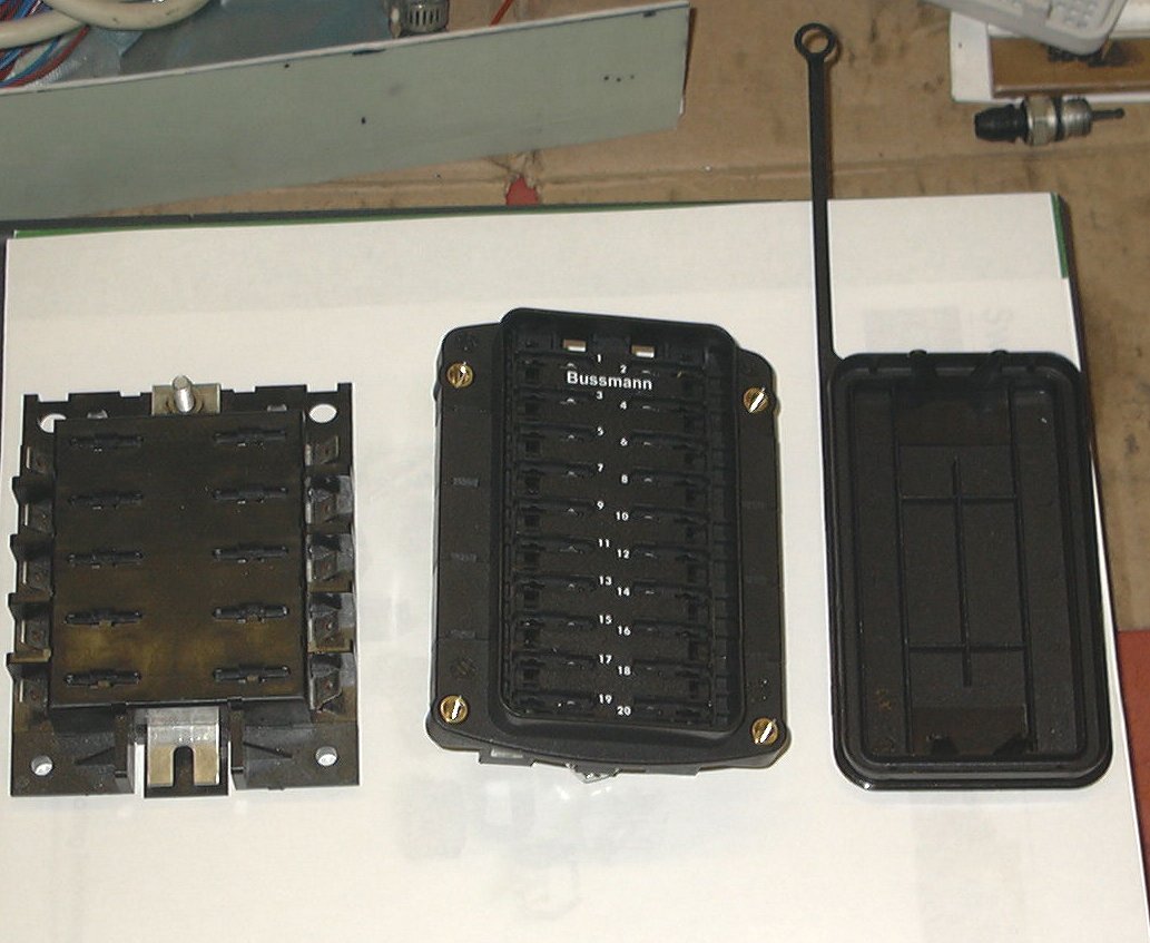

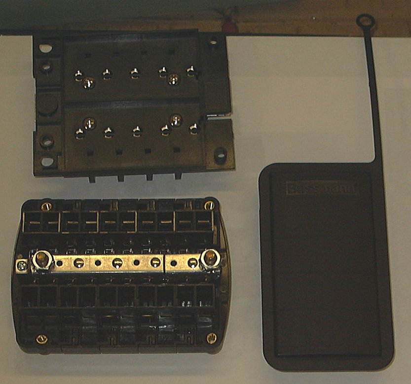

Check out this new fuse block from Bussman. It is physically the same size as the older 10 fuse units, but holds 20 fuses. It mounts from the rear with 4 #8 screws. All the wiring exits the rear as well. It comes with a nice cover and it is of a "split bus" design, so you can use one block for both main and essential buses. See attached photos for comparison. I bought mine from MIH. He gives you the block, an assortment of connectors and the connector removal tool. Great guy to deal with.
