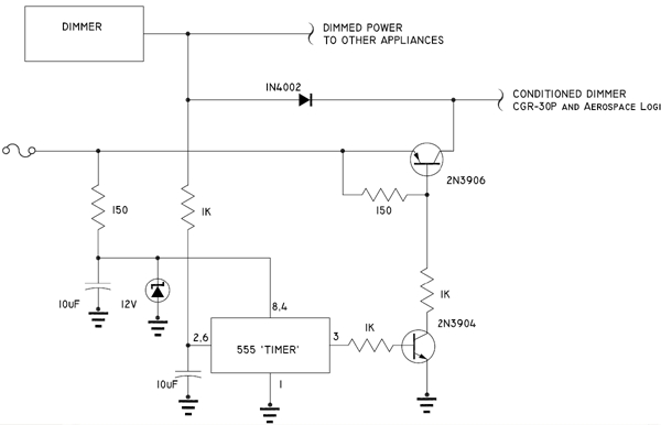

PostPosted: Tue Apr 07, 2015 8:20 am    Post subject: Dimmers driving displays... Reply with quote
I spend a lot of time on the road these days . . . useful for
what I call "asphalt design time". Here's yet another option for
slaying Andy's dimming dragon . . .
Few pieces of silicon have enjoyed so long and rich a history
in electronics as the 555 timer. I remember seeing the data
sheets on this device from Signetics . . . a sales
rep dropped it off with several others at my first TC aviation
design job at Electro-Mech about 1975 . . .
I won't go into details of its features here but suffice it to
say that this device might fit into yet one more application that
Mr. Camenzind probably never imagined.
http://tinyurl.com/yb23fes
In the schematic below, we see how the 555's two comparators
biased at 1/3 and 2/3 of supply voltage can be used to provide
functional logic that goes to the task at hand.
[img]cid:.0[/img]
Wired as shown, dimmer output voltage sample is applied
to the two comparators on pins 2 and 6. If the dimmer
output goes lower than 4v, pin 3 goes HI and turns
the two transistors ON thus applying full bus voltage
to the two instruments needing special attention. If the
dimmer output is cranked up to more than 8 volts, the
555 output goes LO and turns both transistors off. Under
this condition, dimmer output has control over the
displays on the two instruments. It remains in this
condition until dimmer output is dialed down below 4
volts whereupon, the 555 'flips' to the daytime
lighting condition.
This circuit could be spider-webbed into the back
shell of a D-sub connector . . . not unlike the
relay packaging project we discussed here on the List
last week.

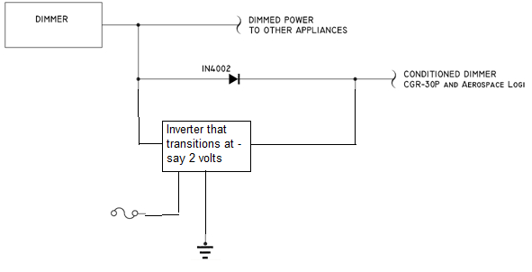

PostPosted: Wed Apr 08, 2015 11:31 am    Post subject: Re: Dimmers driving displays... Reply with quote
Ken, The LM723 look interesting. Are you suggesting wiring it as a voltage follower and using the inverter line to drive the output to high when the dimmer is turned off? How would I wire this thing and are there any special considerations needed?
Or, can something as simple as this be done... The diode in Bob's circuit got me thinking.
If the output of the inverter is high impedance when it's output is low, the voltage from the dimmer would cross the diode (with a diode drop - not a problem - just calibrate the brightness accordingly.) When the voltage on the dimmer dropped low enough that the inverter went to high output, the diode would block that voltage from the "dimmed power to other appliances" yet apply that voltage to the CGR-30P and Aerospace Logic...
It's been too long since circuits class - way too long.
I appreciate the input and thoughts!

> Ken
That one doesn't 'pop out' at me. Can you share
a sketch?
A sketch you say...
The LM723 is an older but versatile voltage regulator (currently $0.75
from digi-key).
The 14 pin DIP has a 7 volt reference, a comparator, and a 150 mA
capable transistor in it. All good things for this type of circuit.
However sketching it out reminds me that its output is a NPN transistor
so the diode and 2N3906 from your 555 sketch would still be necessary
which negates any meaningful parts reduction. Also forgot that it has a
5volt differential comparator input limitation that complicates things
just enough for me to loose interest in using it for this application.
The equivalent circuit on page 2 of the Texas Instruments data sheet
illustrates the part nicely.
http://www.ti.com/lit/ds/symlink/lm723.pdf
I have used this part for outdoor equipment which is why it came to
mind. I'll likely use another one on a Briggs lawn tractor that has no
regulation. The tractor is half wave DC and only rated at 3 amps but it
ramps up to at least 17 volts and tends to kill batteries. Several of
the discrete parts in the example circuits such as C1 and R3 are not
usually required. Since it can tolerate 40 volts, it doesn not really
need any input power conditioning. The current sense resistor (Rsc) and
connections to the Current Sense (CS) or limit (CL) pins are not
required. The plastic DIP version only has commercial temperature
ratings but it has worked fine for me for many years winter and summer
on outside equipment.
Ken
