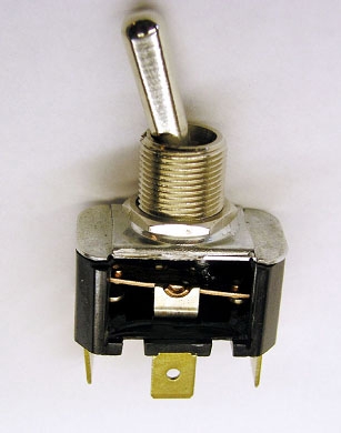

Take one apart and see how it works . . .
[img]cid:7.1.0.9.0.20150611081432.020ee990(at)aeroelectric.com.0[/img]
