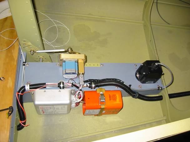

Here's what I did, I had it on my web site at one time but have since removed some of the older stuff:
[img]cid:part1.06070105.05090509(at)charter.net[/img]
I ran conduits under my baggage floors to run wires.

I also like Bobby Hester picture, since that belly skin is an oil
canner and those rails should stiffen them up a bit!
Denis Walsh

bicyclop(at)pacbell.net Guest
Posted: Sun Jul 02, 2006 5:01 pm Post subject: mounting strobe power supply in RV-6/6A |
Hmmm, I don't think that will help with oil canning. It looks as if the rails are suspended on each end at the bulkheads and not in contact with the skin. I bought another rib from Van's - the one that the elevator bellcrank is mounted to (sorry I don't have the part # at my fingertips) and fit it parallel to the existing one and made a sort of avionics deck.
Things wound up crowded and I mounted on the side of it. That black thing at the aft end is a remote compass sensor which I’ll probably end up not using.
Pax,
Ed Holyoke
| Quote: | I also like Bobby Hester picture, since that belly skin is an oil
Denis Walsh

sheldonb(at)frontiernet.n Guest
Posted: Mon Jul 03, 2006 4:02 am Post subject: mounting strobe power supply in RV-6/6A |
Ed, Just some information for you... I have the AK-450 ELT as you do... The mount for the mounting strap broke (at around 300 hours)... Not sure why, but might be from unhooking it and re hooking at battery change times or from viberation... you might think of beefing this up... for if it came loose back there... not good...!
Sheldon RV6A 400 hrs
Posted: Mon Jul 03, 2006 8:18 am Post subject: mounting strobe power supply in RV-6/6A |
Sheldon,
Thanks for the heads up. This airplane isn’t flying yet, but I’ll make sure to put a line in my inspection checklist to give it special attention when it does.
Pax,
Ed Holyoke
