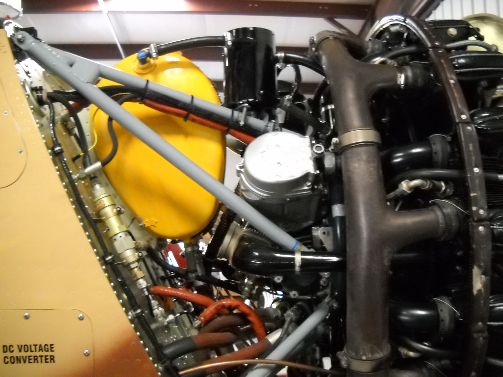

The M14 as mounted in the Yk 52,etc. has all the aerobatic goodies,
effective separator, vent change-over valve, etc.
Some CJ photos attached.

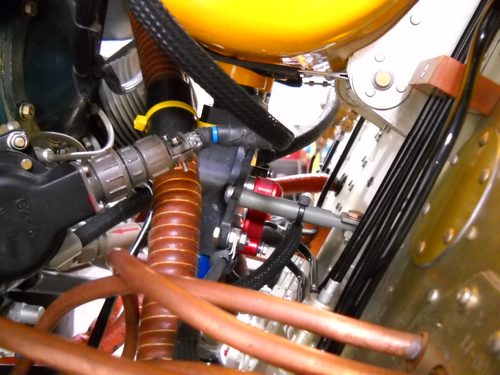

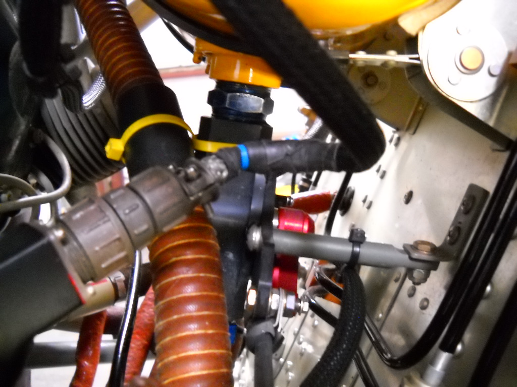

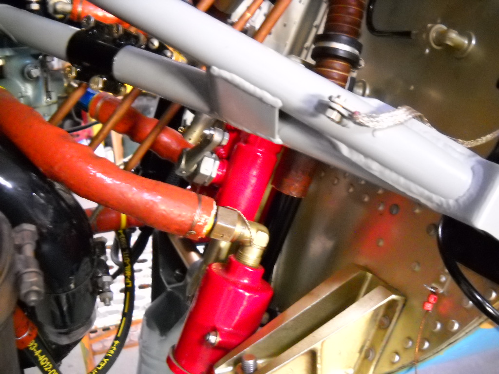

As you see in the photos I have de-activated the original and vented the
tank directly to the separator. Negative "G" will transfer some oil from
the tank. The nose case and main case vents are joined with a 1" hose and
the main vent pipe is modified with a 3/4" nipple attached by welding. A
3/4" hose attaches that to the separator and a 1/2" hose returns drain oil
to the crankcase. The separator vent outlet is via a 1" SCAT type hose
exiting at the lower left firewall.
I have yet to see even the slightest trace of oil exiting the vent (it is
always bone dry) or any trace of oil on the belly.
