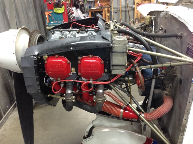

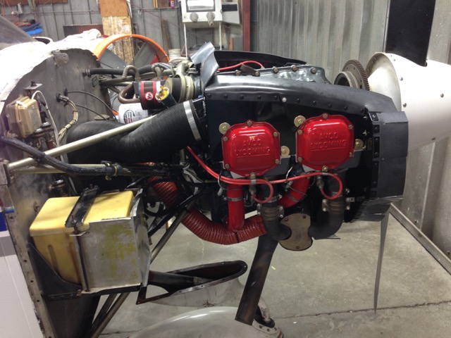

I removed the old cylinders, measured the cam (the owner wanted to know
if there was any measurable wear on the cam. I used the tool for valve
guide wear to measure the cam. I had to fabricate a mount.) I cleaned up
the block, checked all of the bolts, fixed all of the wiring firewall forward,
removed the excess grounds, replaced the mag P-lead wires with new
wires, installed the engine analyzer, wired it up, and when the new
cylinders came, I installed them and finished up the wiring. The new baffles
were sent out for powder coating as were the push rod tubes, intake tubes
and rocker covers. About this time, the owner called and said he wanted all
of the old avionics replaced. It was then that the owner told me he only had
$14,000 in the engine reserve to overhaul the engine at TBO. One of the
other owners called and said he wanted to take the plane to Oshkosh two
weeks away. He began calling everyday to determine the progress.
I guess I shouldn’t have started the avionics removal. I had to track down
wiring diagrams and rewire the intercom. The good news is, I found a bad
wire in the PTT, a bad mic jack for the pilot, and a broken wire in the right
rear seat. I did all of this work without charging the owner. The second
owner wanted a cost estimate and a time estimate to finish the plane.
So, the next morning, I pulled an estimate out of the blue and sent it to him.
I’d never installed an EDM 900 so I took my average time to install an EDM
730 and added 4 hours. I forgot to include the time required to install baffle
seals. I also forgot the time required to replace the DGO-10 they’d sent. I
also forgot to provide an estimate to do the initial break-in of the cylinders
that had been requested. My overall estimate was off by about 24-30 hours
plus $650+ in parts.
As for the engine mounts, the owner never called back so I replaced the
bottom mounts with some good used mounts I had on my shelf. I also
replaced the #2 exhaust riser. The fabricated panel for the engine analyzer
came out nice. The rear seat headphones work. I relocated the music jack
to the left side near the pilot’s head phone jacks.
Six weeks after this project began, the plane was done. I tried very hard to
get it done for Oshkosh. Missed it by one day. Most days were 10-12 hour
days. Total labor hours just over 131 hours including the annual. The engine
compartment is nice and clean and the plane flies great. No wires hanging
in the way. I would like the analyzer to be closer to the pilot but the iPad
mount fills the middle of the panel The final invoice came out to be about
$3650 higher (including $650 in parts and after discounting $2100) than the
estimate I gave them. They don’t want to pay the final invoice.
Lesson learned: always over estimate the cost to finish.
Good news is, one of my other customers has loaned me $6500 so I can pay
my mortgages (two houses) and pay for parts. Another customer has
offered to bring his plane in two months early to help. A big thanks to
them.
Time to go to work.
