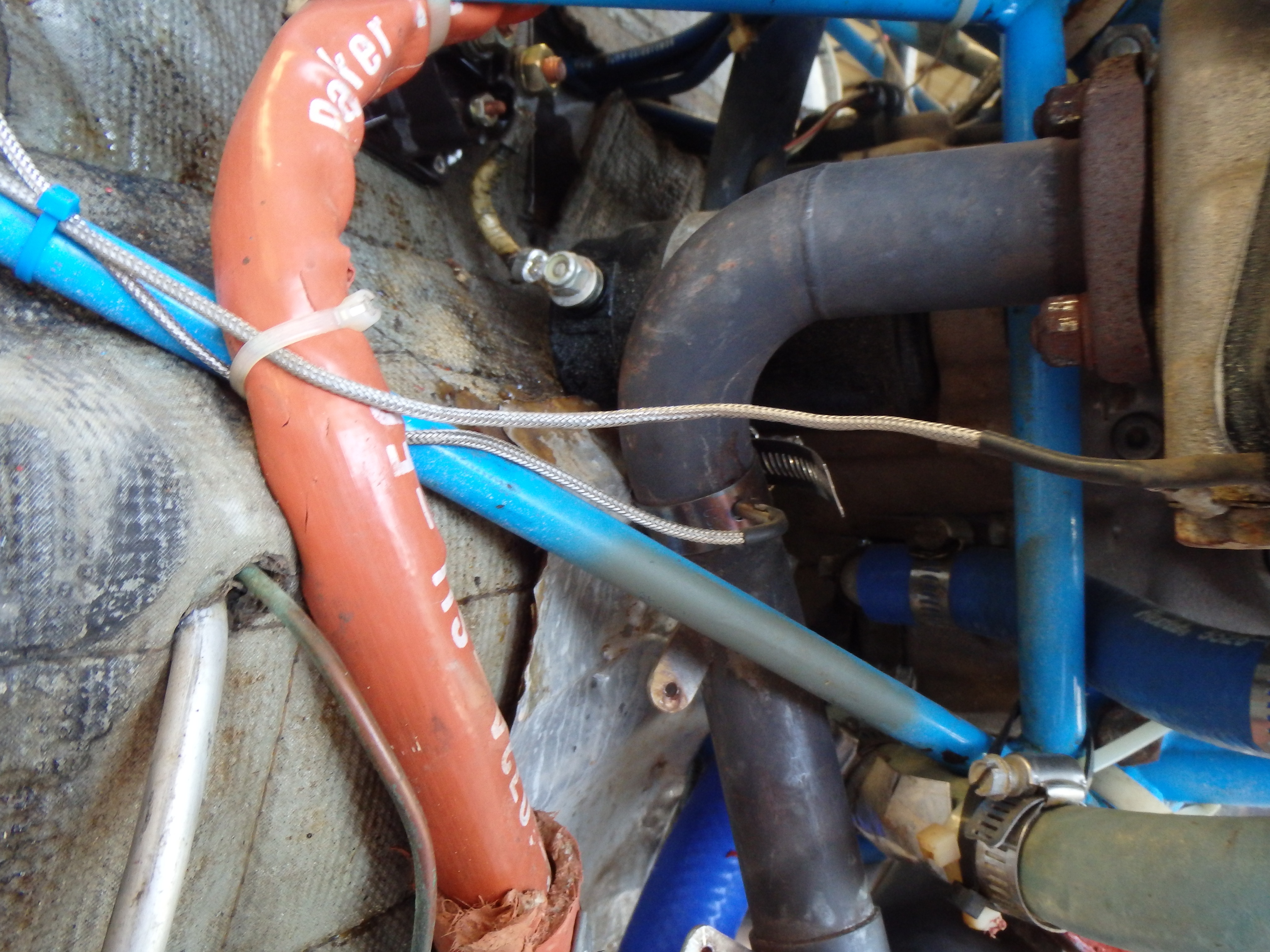

Mine just has some very thick aluminum foil or sheet glued on the blanket near the muffler and exhaust. 1991 Kitfox 3 912 1100 hrs.

PostPosted: Tue Mar 15, 2016 6:49 pm    Post subject: 912 muffler heat shield Reply with quote
Here's a picture.

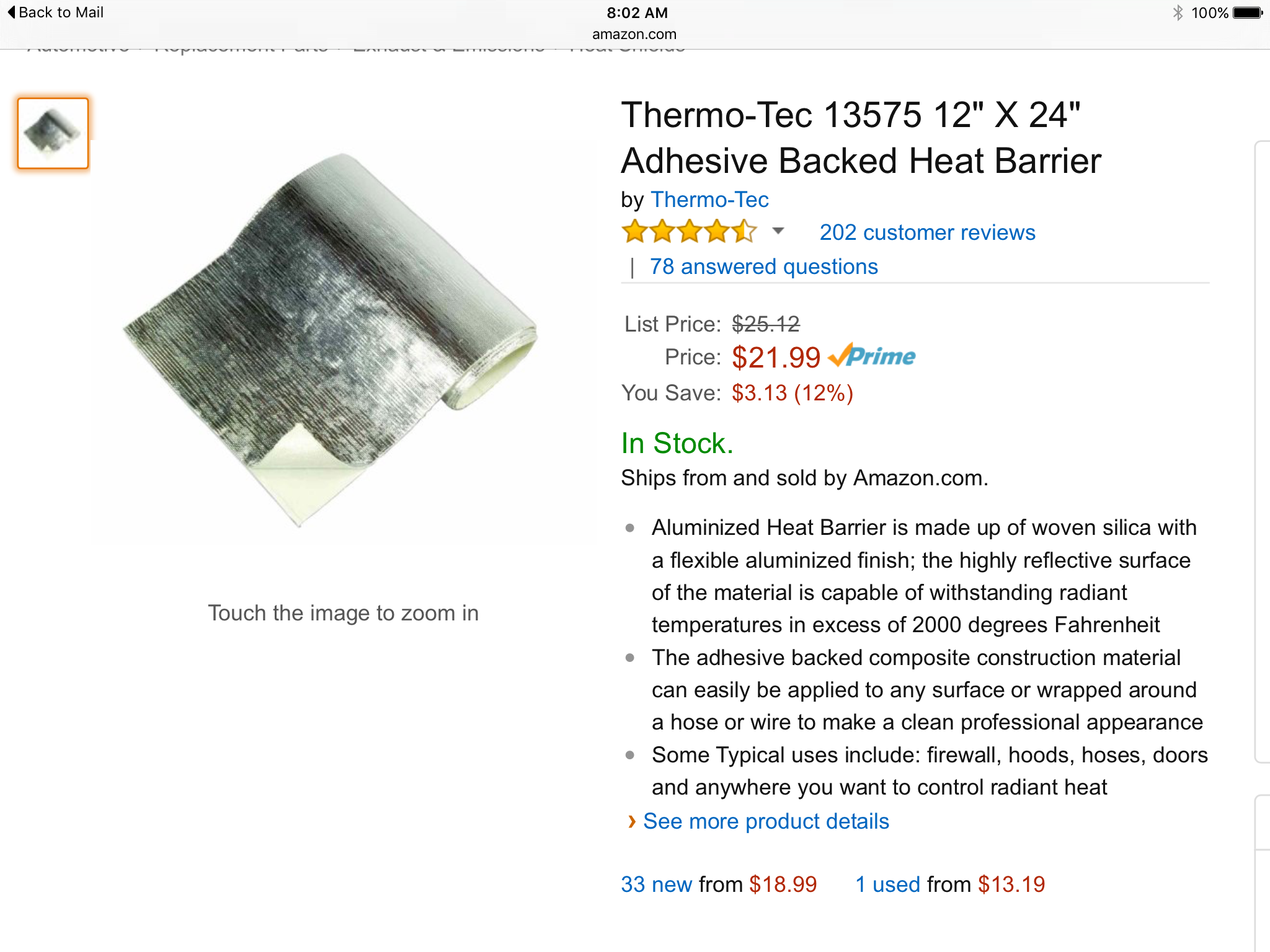

PostPosted: Thu Mar 17, 2016 5:05 am    Post subject: 912 muffler heat shield Reply with quote
[img]cid:15985344-A332-4825-9BDC-8666E51F147F[/img]
Maybe this would work.
Pete
