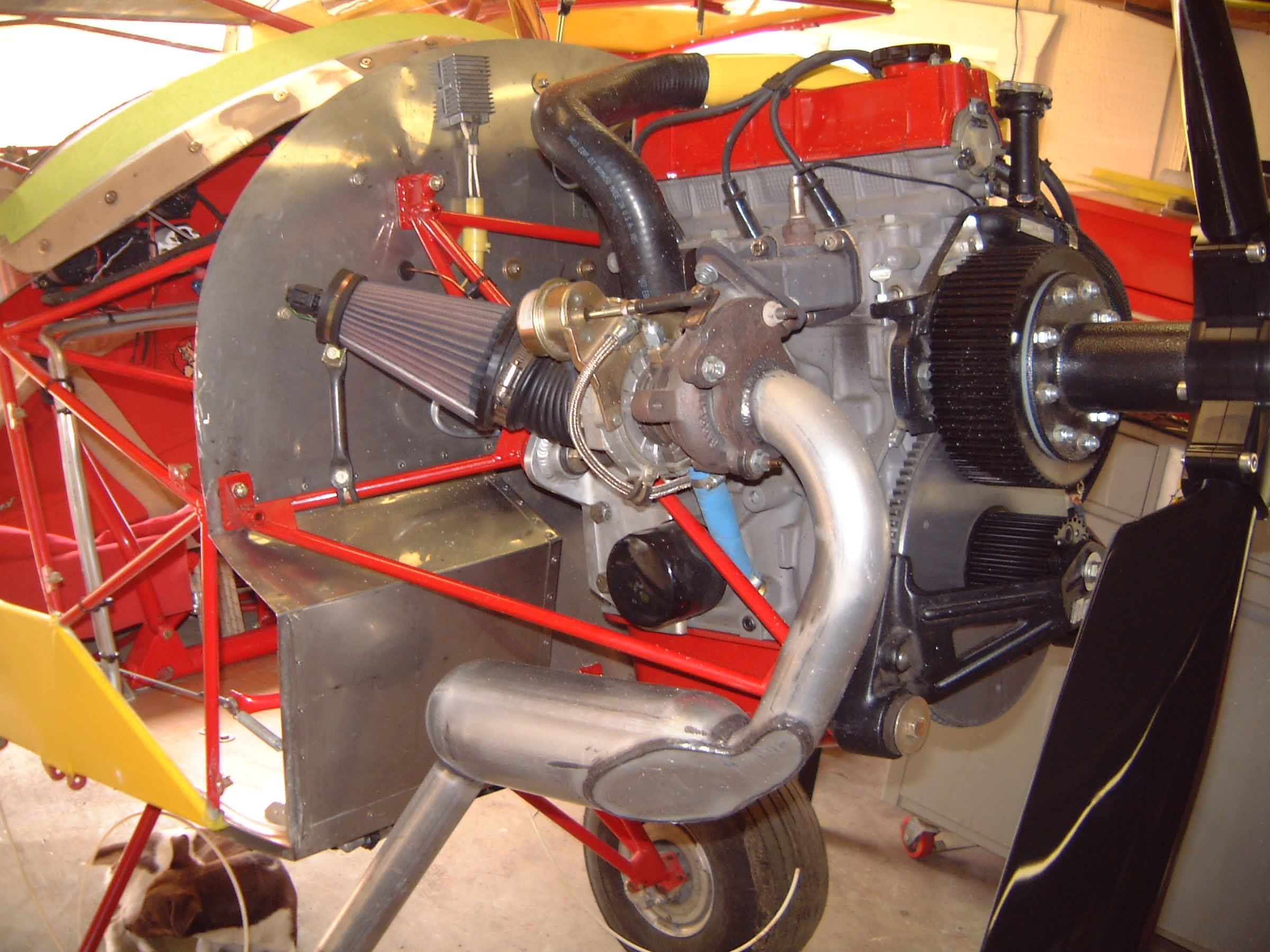

bmwebb(at)cox.net
PostPosted: Sun Jul 09, 2006 7:18 am    Post subject: Motor mounting Reply with quote
Actually, the thrust numbers out there indicate the Geo 1.0L is pulling nearly as strong as the 582 with a good prop. But, what really helps is the flat torque curve. The Geo actually out-performs the 582 at anything less than 75 percent power. In fact, at 5 percent, the Geo is almost double the torque. Basically, this means you don’t have to run full-out in cruise to get more from the motor.
And no comparison at 2gph vs. 4gph. Even turbo’d, the 1.0L is 2.5gph.
Also remember that the Geo 60hp figure is SAE net (mandated by federal law for autos), and the Rotax is SAE gross hp. They’re actually very similar.
Add a small turbo and hi rpm cam ($600), and then you’re in 912 territory. Use the 1.3L with turbo, and then your in (and probably over) 914 territory. All for far less than $10K, and that’s a pre-built, bolt-on setup. Do it yourself, and it’s more like $5-$7K.
I had several criteria in looking for 582 replacements. Things like air-cooling, same weight, fit in the round cowling, and reliability. Performance was a distant 5th. But I got that too. Obviously, air cooling was out, and the V-dub is no better than the Rotax, reliability-wise. The 3 cylinder with Raven belt drive is the same length as the 582, and I’m going to two 6 gallon tanks, instead of one 6 and one 13.5. 6 gallons of mogas is 42lbs, so it weighs the same. With TBI, no choke, no cold/hot start issues, and OBD checks for faults. Same as a car.
Of all the people I’ve talked to, not a single one has had a failure of the motor. No crank breaks, not even leaks. Oh yeah, the one guy last week who bolted up a turbo with no waste gate and blew the head off, but that requires no explanation.  The base motor is Suzuki, and it’s really strong on the bottom end. The redrive is off the transmission side, and the thrust bearings are stout. There are a ton of these on open-air trikes, but very few on Kitfox/Avids.
I think it is a terrific alternative to the 582.
I’m using the IVO 66 inch three blade. I’ll do thrust tests to see if I get comparable numbers, but the IVO is easy and popular.
BTW, the attached pic is of a Kitfox with turbo Geo 1.0L. Don’t drool on the picture, please…
