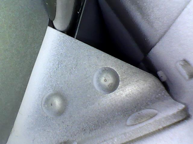

I used my Samsung Galaxy S5 Cell phone camera to take pictures.  I have attached the raw and cropped photos for reference. I only attached the right side so as to not clutter up the forum with picture data.  I reduced the size of the "Raw" image to allow it to post. but you can see what the camera took before I cropped and zoomed the area of interest.
Turn on the flash, auto-focus and insert the camera in the inspection hole with the camera just inside the hole and the phone resting on the edge. Take the picture and then crop / zoom in on the area of interest. Did the same thing on the outside with the aileron up and down.
Both sides took 20 minutes.
I think this is good enough to do the inspection. Someone correct me, but I don't think removing the flaps and ailerons exposes much more of the area?
Aircraft has 856 hours over 5 years of flying.
Jim C

I too was able to inspect the area without removal of the flaps or ailerons. I took pictures with my Samsung phone and they turned out just fine.
856 hours total time - no cracks.

The pictures I attached earlier from the Amazon inspection camera were taken by routing the camera behind the gap fairing using the enclosed mirror.

PostPosted: Mon May 16, 2016 9:44 am    Post subject: Service Bulletin Reply with quote
I used the ViVida AbleScope VA-400 ($150 from Amazon) with the tip
articulated to 180 degrees (so the scope is looking back at the
handle). This worked well on both sides, so I don't see the need to
remove the aileron and perform surgery on the gap seal. I'll attach a
photo so you can see what I was able to capture with the scope.
Tim Lewis -- HEF (Manassas, VA)
A&P
RV-6A N47TD -- 1104 hrs - sold
RV-10 N31TD -- 740 hrs

Tim Olson
Joined: 25 Jan 2007
Posts: 2882
PostPosted: Mon May 16, 2016 10:00 am    Post subject: Service Bulletin Reply with quote
That's great to hear. I got mine and it looks like it will be a very
nice tool for
many things. The best photos of inside the wing I saw came from cell
phones, but, if you need to inspect a cylinder, or under a flap gap seal,
this camera really looks like a time and energy saver.
Tim
