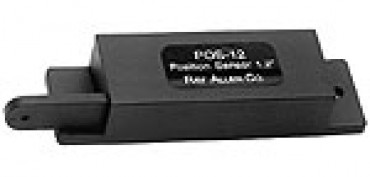

Hi Don,
I think you want one of these:
https://www.aircraftspruce.com/catalog/elpages/racpos12sensor.php?clickkey=35250

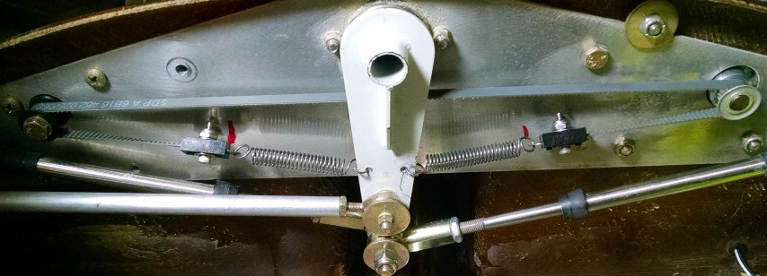

I'm looking for some idea on how to implement a trim position sensor.
Attached is a picture of the aileron trim mechanism.
DC motor on the right drives a cogged belt with an idler pulley on the left. There is no limiter on the motor. It can run continuously. When it is unable to pull the bellcrank, the belt begins slipping.
The mechanism works fine. I'm not looking for a new trim mechanism.
But I would like to know where the system is positioned. I thought about a small magnet on the belt and then some type of sensor but I think that would be too coarse.
So I'm wondering if anyone has any ideas on how to implement a sensor.

how about a servo potentiometer geared to the idler pulley

Hey Matt,
I thought about that. But since this isn't a linear mechanism, I couldn't figure out how to implement that sensor.

PostPosted: Wed Dec 14, 2016 12:25 am    Post subject: Trim position indicator Reply with quote
Your trim system is a "spring bias" system. The belt spring connection could be used to drive the device that Matt suggested. Thete are a few caveots.1 the sensor has only 1 inch of travel.
2 you would need to find the "neutral point by trial and error
3 if the belt spring connection travels more than 1 inch total you would need to usr a bell crank to cot the input to the sensor to one inch total.
4 spring tensions must be equal with neutral trim (only in the air unless your elevator is fully balanced)
Set up, double sided tape the sensor so that a rod connected to the belt spring connection and attached to the slide in the sensor pushes and pulls the sensor slide as the trim is moved up and down.
If the indicator register bsckwsrda, swap the power and return wires on the sensor. Fly and move trim. If tbe center point is too far off mlve the sensor in or out to correct .
Hope this helps. Btw this is similar to the aileron trim set up in an RV7 except it is driven by a servo with the motoon sensor built in.

I've been mulling this over the past few days.
Had to spend a lot of time on the road . . . good
opportunity for sifting the seeds of ideas.
That idler pulley seems the opportune
location for tapping into trim system position
data. With a little creating work on a small
lathe, you could remount that pulley on
a shaft supported by a bushing extending
through the mounting surface. Is there room
behind that bulkhead to mount a potentiometer?
It seems likely that full stroke travel of
the trim system will not produce more than 10
revolutions of the idler pulley. The pot
would be rigged to produce 50% of full scale
voltage with the trim system mechanically
neutral.
Simple electronics can offer electrical adjustment
of the pot voltage should mechanical neutral be
offset from aerodynamic neutral.
If you had a voltage representing trim postion,
where/how would you display it?

That idler pulley seems the opportune location for tapping into trim system position data. With a little creating work on a small lathe, you could remount that pulley on a shaft supported by a bushing extending through the mounting surface. Is there room behind that bulkhead to mount a potentiometer?
Yes, that would be an elegant solution. There's plenty of room on the forward side of the bulkhead. However, I don't have access to a machine shop. Sad
The position data would be sent to the VPX. It has inputs that can handle the Ray Allen position sensors which then displays it on the GRT HXr EFIS.

I'm going to Wichita today and may have
a chance to meet with my counterpart in
the mechanical side of our cooperative
endeavors. I may have an idea for fabricating
a potentiometer assembly on your idler shaft
using ordinary hand tools . . . Gene will,
no doubt, have some ideas to contribute . . .
need to know if your idler pulley has
a built in bearing to function as an idler
or does it attach to a shaft that is carried
through an external bearing.

Bob,
The idler has an integrated bearing and is held in place with an AN bolt.

put a gears wheel on the shaft of a servo pot and bolt it to the bulkhead so the toothed belt is tangent to and drives the gear.

That seems the simplest approach . . . what are the
pitch and width of the cog-belt?
I like it! Very Happy
I can pick up another cogged pulley that has an ID which will fit over the shaft of a pot.
Now I just need to figure out what type of pot. Since the VPX will accept an RAC trim position sensor, does anyone know what the spec's are for that? I'm assuming that it's basically a linear pot.

Another builder informed me that the Ray Allen servo pot is 5K ohm.
Unverified.
The value of the pot is very non-critical . . . 1 to 10K would
work . . . it's simply a voltage divider that is biased up
with a 5v source from your EFIS system.
You'll want a MULTI turn pot that will accept more
rotation than what results from full-stroke motion
of the cog-belt against the add-on pulley. Here's
a likely candidate . . .
http://tinyurl.com/gn4rs23
for a 10-turn device to which you can add the pulley
and bracketry to make the installation.

I'm making some progress on this.
The VPX guys say use a 10K linear pot.
I've determined that with the appropriate timing gear that I'll be getting 3/4 of a revolution total. Which means I don't need a multi-turn pot.
And I just happen to have a 10k pot in the drawer (Alpha 813 B10K). And it's got a 1.75" shaft (which is very important since that bulkhead is rather thick). But I can't tell if it's linear or audio taper. At 50% of travel, I'm getting about 6K ohms.
IIRC, if it's an audio taper 10k pot, at 50% of travel, I would be seeing about 3k.
Does anyone know if this particular pot is linear or audio taper?
alec(at)alecmyers.com
PostPosted: Thu Jan 05, 2017 4:33 pm    Post subject: Trim position indicator Reply with quote
Most audio pots aren't really logarithmic, they're a two or three straight line approximation. The 25% and 75% travel resistances should enable a better determination, but the B in the code usually means linear taper.
I'd most definitely use a dedicated servo pot, cheap panel pots wear horribly and lose contact; not much of a deal if your old amp volume knob goes a bit crackly, but probably not helpful in your application.
What's a "servo pot"?
This will provide a visual indication of the trim position. Something that I haven't had before. So if it stops indicating, it's absolutely not a problem. If it stops rotating, that would be annoying, but not insurmountable.
Edit: just did some googling on servo potentiometer... Holy crap! $60!
http://www.ebay.com/itm/Rotary-Potentiometer-Wirewound-3549S-Series-10-kohm-Linear-10-2-W-Servo-/401236171094?hash=item5d6b8a1956:g:7rMAAOSwcUBYQNgh
If that's what they cost, I'll keep tooling around without the trim indicator. Sad
