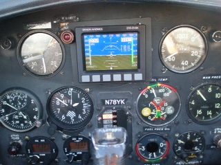

I have the Dynon D700 plus the EMS 9 cylinder EGT, 3 cylinder CHT, two voltage buses, gear and flap monitor only right now. My AHRS is mounted in the tail.
 Filesize:  100.03 KB
 Viewed:  12305 Time(s)
