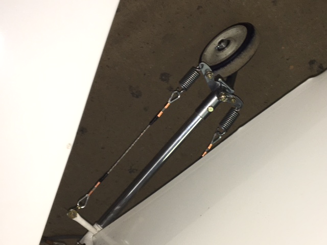

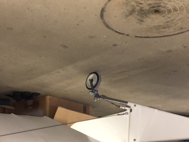

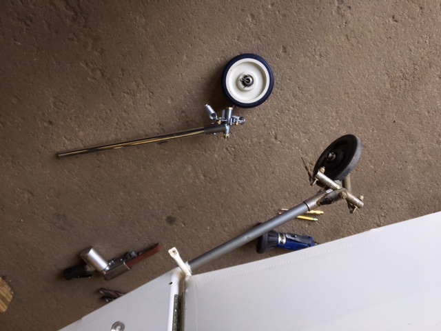

Heat will definitely break JB weld loose. I actually just replaced the tailwheel on my Firestar 1 with the new Kolb breakaway unit. I had drill out the fiberglass tail strut which was a real pain, but JB had failed at tailwheel assembly. So I installed a new T7075 tail strut. I just locked it into lower vertical stabilizer with a single bolt at both ends. Here's a couple of pictures.
I did coat the inside of both end with a liberal amount of white silicon to seal out moisture.
George H.
