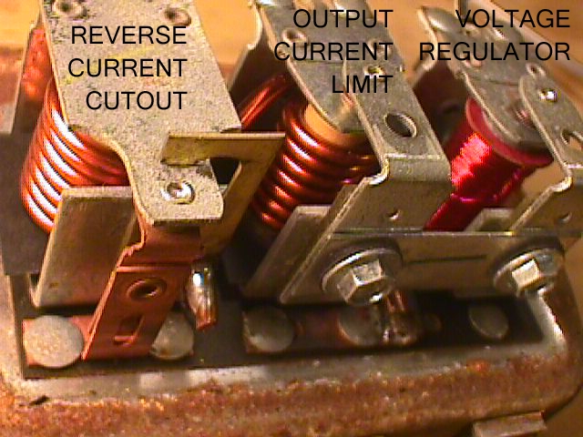

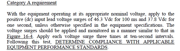

It doesn't matter. Waazayyy back when, the exemplar generator
regulator had three principal components. Three relay-looking
devices were configured (1) to prevent the back-feed of battery
voltage into the generator (making it run like a motor), (2) an
output current limiter to prevent smoking the armature wires
due to overload and (3) a voltage regulator.
[img]cid:.0[/img]

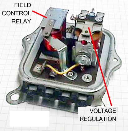

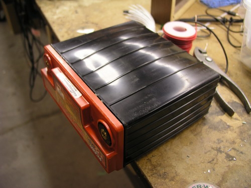

Unlike the generators of yesteryear, an alternator is
inherently current limited by its magnetics. This feature,
combined with the diode array (converts stator winding
AC voltage in to battery friendly DC) means that CURRENT
LIMIT and reverse current cuttouts are not necessary.
[img]cid:.1[/img]
The key phrase in the foregoing narrative is CURRENT
LIMITING. Whether you're speaking of generators or alternators,
there is a finite limit to the current they can supply.
That current level is only a small fraction greater than
the nameplate rating of the machine.
Wwwaaay back when, the avionics master switch was
perceived to be a prophylactic against 'spike generated
by starters'. In years since, DO160/Mil-STD-704 design
verification guided the appliance designer in the
simple task of making their product immune to any
voltage excursions one might expect from the ship's
DC power system. Over those same years, I've had
occasion to attach data acquisition systems to dozens
of airplanes. Like the elusive 'snipe', no matter how
close I looked or longingly I called . . . no such
critter ever emerged.
A question I've asked dozens of appliance engineers
goes something like this: "Under what conditions of
normal or inadvertent abnormal management of the aircraft's
power system will bus voltage exceed catastrophic
failure limits for your product?"
The real answer should be "none". In 50 years
of working with alternators, starter generators
and batteries both in the lab and in aircraft,
I've never had the slightest concerns for turning
batteries and alternators on/off in any order.
An alternator coming on after the engine is started
may deliver a small overshoot . . . usually less than
1 volt due to regulation dynamics. But in no way
can it push the bus to levels suggested by your
radio guy.
Another set of questions to ask: "How much current
do you need to push into a battery to elevate the
28v bus to say, 50 volts?" The answer is:
"hundreds of amps for an EXTENDED period of time . . .
like tens of seconds."
The next question: "How does an alternator rated
at 60 amps produce such an event?" The answer is:
"It can't".
If the ov protection system built into the radio
was damaged, I hypothesize a design or manufacturing
flaw. I'd be willing to help them sort it out . . .
<2afa004.jpg>
<2afa061.jpg>
radio guy.
"It can't".

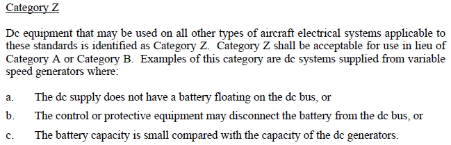

the ov protection system is still expected
to bring the alternator to heel in a time
frame LESS than 100 milliseconds.
Given that your supplier speaks of a 50 volt
ov protection system, I suspect the appliance
is qualified to DO-160 Category A for abnormal
DC surge voltage. Quoting from DO-160 we find.
[img]cid:.0[/img]
These numbers give rise to a design goal for ov
protection systems to LIMIT a runaway alternator's
output voltage to less than those values in the time
frames cited.
Or is it just this particular avionic that cannot be damaged by an alternator but others are vulnerable? Or something to do with it being a 28V system instead of 14V?
No. If your battery was on line at the time of the
radio's failure . . . then there was no way that
bus voltage would rise to levels claimed by the
radio technician. If the battery were off line,
then you would have experienced a trip of the
ov protection system in an magnitude/time frame
that was UNDER the envelope cited in DO-160.
You are not the first owner/operator of an aircraft
to be told that "a spike from your airplane killed
your radio" . . . but in fact, if your battery was
on line and you did not experience an ov trip, then
there is no way that your airplane put any stress
on the radio that it was NOT designed to deal with.

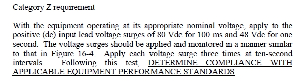

14 volt appliances use 1/2 the 28v qualification
levels. I've always designed to Category Z.
[img]cid:.1[/img]
[img]cid:.2[/img]
Note that category Z considers the extra hazard
for having a very small or no battery at all.
It's not hard to do . . .

PostPosted: Tue May 02, 2017 10:00 am    Post subject: Overvoltage event (non-lithium battery) Reply with quote
At 08:33 AM 5/2/2017, you wrote:
--> AeroElectric-List message posted by: Alec Myers <alec(at)alecmyers.com>
If the OV protection is absent, a defective regulator regulating the bus voltage to 18V (for a 12V system) will eventually damage the battery, but not the avionics.
Yyeeaah . . . sort of. A battery that's in good
condition will willingly and ably stand off
most alternators until the ov protection system
can react. If the ov protection is absent, voltage
will rise with a rate dependent on battery condition
and magnitude of the 'overcharge' current.

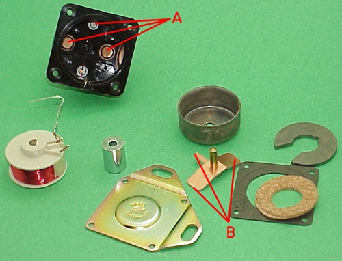

We've seen cases of sustained ov on a good
battery . . . and yes, it's really hard
on the battery. But this event took a long
time . . . perhaps hours, perhaps more than
one flight to evolve to this condition.
[img]cid:.0[/img]
. . . and yes, the battery was trashed. I don't
recall if any other system components were
damaged . . .
So isn't it fair to characterize the battery as being there to protect the avionics, and the OV crowbar being there to protect the battery?
No . . . batteries are there to start engines
and back up alternators. A properly designed
ov protection system will arrest a runaway
alternator before the damages propagate to other
components in the system . . . whether the
battery is on line or not.
It's a happy coincidence that a robust battery
contributes to a graceful recovery from an
ov event . . . but there is no expansion of
a battery's primary role of offering a reversible
chemical energy source.
[img]cid:.0[/img]
[img]cid:.1[/img]

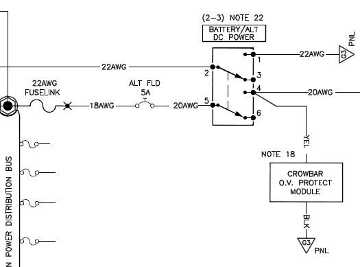

At 07:47 PM 5/3/2017, you wrote:
This may be a naive question but is there any reason why then I can't use one master switch to turn on both the battery and alternator?
If I turn my master off and e-bus on I would then be on battery-only operation.
That's fine . . . in fact, that configuration
is illustrated in Z-13/8
http://tinyurl.com/kgg8nva
[img]cid:7.1.0.9.0.20170504123207.05567330(at)aeroelectric.com.2[/img]
This configuration exploits the fact that
crowbar ovm systems are typically installed
with the popular miniature pullable breakers.
This means that when you want to do battery-only
ground operations for maintenance, you can pull
the alternator field breaker and REMOVE a
significant (2.5 to 3 amp) drain on the
battery by the field circuit of a non-rotating
alternator.
But if you system is all fuses or non-pullable
breaker, then the progressive transfer switching
of battery/alternator (al la legacy split rocker
switches), is recommended.
