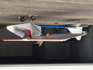

PostPosted: Wed May 24, 2017 3:24 pm    Post subject: Fuel Pump Reply with quote
Thanks, Boyd. I just ordered a new voltage regulator, 40104 Facet fuel pump and the small battery that George A. Suggested. I appreciate all the input that you guys have given me. Hope test fly my Firestar (original) this Friday. Weather permitting.
[img]cid:BFDF1878-531E-4E1B-84F3-9EBFA87FE8FB[/img]
George H.
