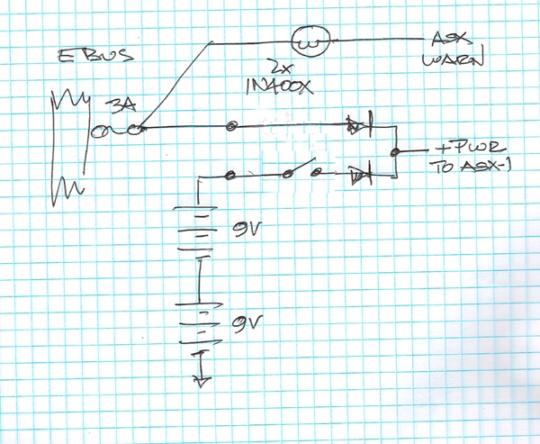

At 11:16 AM 3/27/2017, you wrote:
Bob,
Hesitate to display my ignorance but with the schematic you drew won't the ASX-1 draw power from the higher voltage source, the batteries, until they are depleted to below the E-bus voltage? Won't replacing the diodes and SPST switch with a SPDT (even an on - off - on) with the center contact going to the ASX-1 solve the issue and provide the same functionality?
Tom Kuffel
Nothing ignorant about your observation my friend . . . good
eye! Your suggestion eliminates the conflict you noted.
Here's another alternative. The diodes prevent back-feeding
of either source to the opposite source. The switch
isolates the standby batteries.
Preflight would be modified to close the sb battery
switch first to see that the ASX-1 lights up. Then
turn it back off for remainder of that flight op.
Thanks for the catch!
[img]cid:7.1.0.9.0.20170327161256.0099e920(at)aeroelectric.com.0[/img]
 Filesize:  242.71 KB
 Viewed:  3578 Time(s)
BobD
