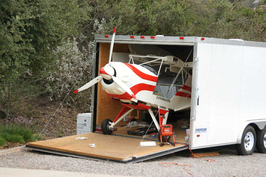

I'm doing the same thing, since it will cost me only $95/mo for the trailer spot versus $450/mo for a hangar here in Ramona. The critical dimensions on my Kitfox IV are the width across the wings when folded, (95.5") and the height of the prop when you try to push it through the door. (~73" with 6x6 tires.) My trailer is 96.5" across at the door opening, which leaves only 1/2" clearance, but it's surprisingly easy to get it in and out. (I'll put 1/4" neoprene on the internal sides, as well, for padding.) I've put a 3" C-channel on the floor to guide the tail wheel, and permanent chocks to guide the mains. I use a 2:1 block and tackle with a Harken ratchet to pull it in or ease it out.
I looked at a lot of box trailers and found most of them too narrow at the door. Mine has the tail lights in the door so the opening can be wider. You can have the trailer made any height, but I was impatient and bought one off the lot with a 75" door opening. I wish it was 6" or 9" higher, since I can't put bush wheels on and fit the plane in the trailer. I also bought a 22' trailer, but a 24' would be better, as my plane fits with only 3" to spare, length-wise. I bought the 22' because it was a lot lighter. (7000# gross versus 10000# gross.) Again, you can have lighter trailers made custom for the same price, but the resale plummets. (These trailers are typically used to move cars.) I put six tie-downs inside and my plane seems to ride very comfortably. I also made wing supports, and will be making a tail support to unload the tail wheel when trailering. (I'll use the wing supports any time the wings are folded, since the fuel weighs a lot.)
Let me know if you have any other questions.
