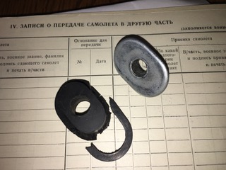

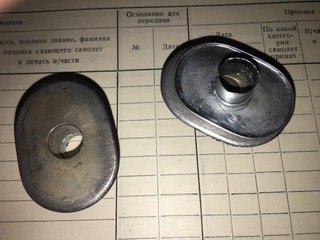

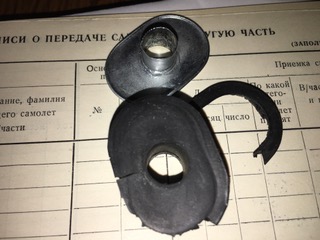

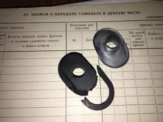

Attached is a picture of the different engine mount rubbers.
On the left 2 new ones with the rubber bonded to the steel insert and on the right one of the damaged mounts where the steel insert is not bonded and can turn and cut the rubber.

I have solved the problem and I am surprised you did not offer the advice that the sleeve does not require bonding....if it is the correct mounting rubber.
The rubbers that were supplied and installed by my mechanic do not have the sleeve bonded. In fact the front rubbers do not even have a sleeve. No wonder they were coming apart.

We just installed a zero’d M-13PF with Barrett Pistons which dyno'd at 435 HP on my YAK 50. Performance is much enhanced however we have just found some engine mount rubbers are being torn up because the metal sleeve is moving and cutting the rubber. The airplane is being flown under the G limits however during the air show sequence I am sometimes seeing +8 and -5 G. We never had this problem with the old 360 HP engine. We have a new set being installed in the next few days which should yield more information. Does anyone have experience in this area? Thinking of bonding the sleeve to the rubber to prevent the sleeve movement. Thanks in advance. Gord

gord(at)thedampub.ca
PostPosted: Sun Jul 16, 2017 12:02 pm    Post subject: [Non-DoD Source] Engine mount rubbers - YAK-50 Reply with quote
Hi Walt.
Hopefully these pictures will help explain the dilemma.
After 20 hrs on the engine.
[img]cid:981E4BF5-D4B4-49B2-AA7C-F3CCD151A0EA[/img] This shows a new mount on top. The old sleeve/washer is sitting on top of the new mount. It is smaller
[img]cid:602B1E73-62CE-4EF5-B325-B5D4CD36F0E8[/img] This is the old rear rubber mount. The sleeve/washer has cut the rubber
[img]cid:FE878353-3735-4492-B3E7-02C1308F4C91[/img] This is the old mount and sleeve/washer another view
[img]cid:B1BC1E63-09E2-4411-A45A-0263CB9DF639[/img] another view of the old sleeve/washer and rubber mount
I was in Mexico when the engine was put on the airplane last winter. I was told that there is no washer/sleeve on the front rubber, only a washer. We won’t know until we get the engine off on Wednesday what exactly is there.
The new rubber mounts I have purchased have the metal bonded to the rubber, both front and back rubbers.
I agree. I too, am confused with no internal bushing in the mounts. I have been told that the measurement between the washers is to be 34.5 mm.
Gord

A comment regarding the two dimension mentioned in this thread: 44.5 mm vs.34.5 mm. The 34.5 mm compression dimension comes directly from an Aeromotors document/diagram 14-000-40DMFI. If one were to use the 44.5 mm compression dimension, that would be 10mm (or about 3/8") LESS compression on the engine mount rubbers. I seriously doubt one could decrease the compression dimension by 3/8" and still get the cotter pins into the castellated nuts on the end of the mounting thru-bolt. I've attached a copy of the Aeromotors document/diagram for reference.
Dennis

wlannon(at)shaw.ca
PostPosted: Sun Jul 16, 2017 4:37 pm    Post subject: [Non-DoD Source] Engine mount rubbers - YAK-50 Reply with quote
Thanks Gord;
Explains a whole bunch. The corresponding part for the Huosai is a simple washer, same shape but no sleeve.
I will call the M14 version a sleeved washer. Noted on the Motorstar drawing that the two sleeves cannot touch each other so not sure of advantage though possibly improved torque load resistance.
One wonders how many M14 powered CJ’s around with Huosai dampers.
Walt
[img]cid:1D10E792167948718CF32B8C8E8D9E9B(at)WalterHP[/img] This shows a new mount on top. The old sleeve/washer is sitting on top of the new mount. It is smaller
[img]cid:EDF80EB162CC4CB2BB40B2B853570C1F(at)WalterHP[/img] This is the old rear rubber mount. The sleeve/washer has cut the rubber
[img]cid:6F509882051941C9B93F4B5D9FED7F6E(at)WalterHP[/img] This is the old mount and sleeve/washer another view
[img]cid:5E43EBEDD9724650A33E326EAD169D71(at)WalterHP[/img] another view of the old sleeve/washer and rubber mount
Gord
>> <rubber.jpeg>

>>>> Mark. I asked for help .....not a lecture on a subject that I am well versed in nor assumptions that are incorrect
>>>> A new 'proper' set is being installed this weekend. I never had this problem with the old engine because it had the correct rubber mounts which were sold with the engine.
>>>> I believe this will solve the problem and I will carry on flying a very aggressive and dynamic AIRSHOW routine that is well within the limits of my airplane which is constantly being inspected.
