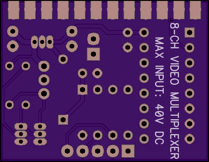

I've got the schematic (PDF attached) and a fist pass at the board layout complete.
I exchanged a few questions/answers with a TI engineer about using the CD74HC4051E, and he told me the main "gotcha" with the part is applying a signal to an input before the IC is powered up. Apparently there's a path from the inputs to Vdd until the internal FETs are properly biased. To eliminate this possibility, I added a small circuit (bottom right corner of the schematic) consisting of a power-on reset (POR) IC and a couple of MOSFETs. The POR watches the +5V rail, and as soon as 1V is reached it begins to hold Q1 off, thus allowing Q2 to be held off by R2. Once the +5V rail reaches 4.85V and a 150mS delay elapses, the reset signal is released, Q1 turns on, turning on Q2 and allowing bus power to reach the cameras. If the +5V rail falls below 4.85V, the cameras are immediately shut off. Assuming the cameras consume ~100mA each, it should be no problem to power eight of them through a single D-Sub pin.
The PCB is designed to fit between the two rows of solder cups on a DB-25 connector and be soldered in place. Q2 will probably have to have its legs bent so it lays back, over the BAT46 diode.
I'd say we're about done for now. Once we see how Wade's RCA-to-USB converter and EFIS handle being switched between camera feeds, and Bob checks the camera output signal, we'll know if any changes are necessary or if we can go ahead with a hardware prototype.

Top side of PCB:
Bottom side of PCB:

But - if you have a PIC, isn’t it a better idea to get the PIC to do the POR? Even if we can’t contrive a way to spare a pin with an 8 pin PIC ou could go back to the 14 pin PIC at no extra cost, and have plenty of IO pins, comparators etc. No extra cost and you save the POR IC.
This sounds like a reasonable idea. Can the PIC12F683 monitor its own Vdd, or is a separate pin required as an input for the comparator funciton?
The camera power is switched through a P-Ch MOSFET, so it's held OFF automatically by a pull-up resistor. If the PIC can pull the MOSFET gate to ground when Vdd exceeds a threshold voltage, then the POR is unnecessary, as is the N-Ch MOSFET to switch the P-Ch.
Since the MOSFET's gate won't be bothered by 12V, we could use the Vpp pin to switch it during normal operation. If a separate pin is required for the comparator input, then we use a 14-pin PIC and have pins to spare.
Never mind this sentence; that won't work. The P-Ch gate has to be pulled up to its source voltage, which is too high for a PIC pin. So, an N-Ch is still needed to control the P-Ch. This would reverse the PIC output logic: Vdd low - output low, Vdd normal - output high.

The brownout reset of the PIC sounds like the right sort of idea, but it holds in reset only until the Vdd rises to between 2 and 2.2V. One could run the PIC from 2.5V derived from a 5V supply with a zener diode/resistor network to hold it off until the supply voltage reaches 4.5V, but then the maximum pin output voltage isn’t guaranteed to be higher than 1.8V, which won’t drive the switching inputs of the multiplexer. I don’t think I’m cunning enough to make that work with an 8 pin device.
If you have room to go back to the 16f18323, it has an internal 1.024V fixed voltage reference and a comparator module. If we set the voltage reference as an internal input to the comparator, and connect the centre of a two resistor potential divider from Vdd to the external input of the comparator then you can easily detect when Vdd rises above an arbitrary threshold. Then you can have a logic output some chosen delay after the supply voltage rises above an arbitrary threshold.

Just wanted to let you guys know I hooked up 3 cameras to the switching unit that you recommended Eric and fed it into the GRT EFIS via the switching unit's RCA jack out into the USB adapter.
The switching worked fine, albeit their is a VERY brief (less than half a second) skewing of the screen as it goes from one video input to the other. You have to be looking right at it to see it.
Again, it all looked fine to me. If we could eliminate the skewing it'd be nice, but definitely not a showstopper.
I'm glad to hear it works OK and the EFIS doesn't lose sync on the video signal. Thinking out loud here... the brief skewing you see may have something to do with the mechanical switch. Perhaps it's a break-before-make type, so for several milliseconds there's no signal present. With the switching done electronically, the loss of signal will be reduced to a few tens of nanoseconds, so that issue *may* disappear.
