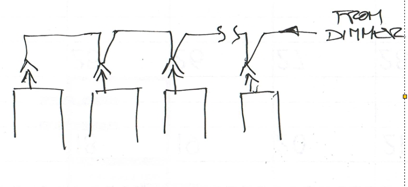

[img]cid:7.1.0.9.0.20171208131056.0580fd50(at)aeroelectric.com.0[/img]
Illumination feeders to multiple swithces
can be 'daisy cahined' with short segments
of wire crimped into the fast-ons as suggested
above.
Eric Jones offers a little dimmer assembly (noise
free) that would work nicely with this task.
https://goo.gl/ndNhX3
