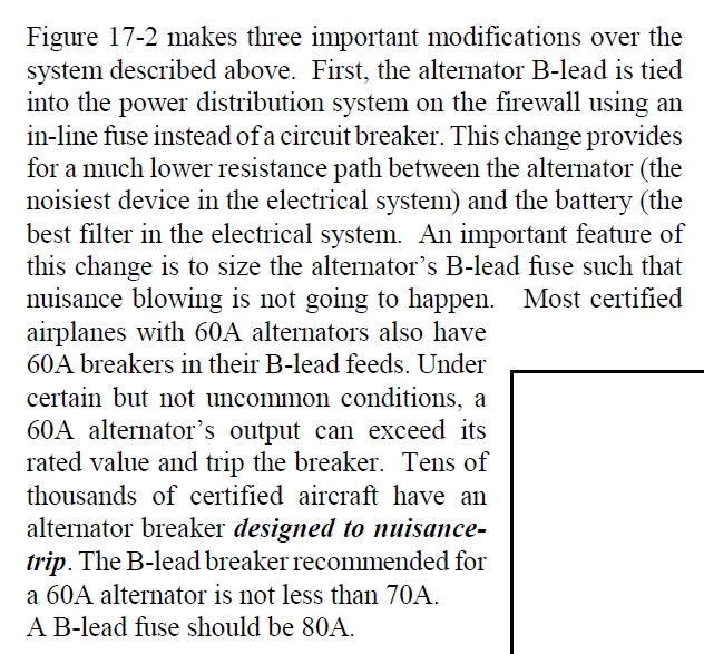

The alternator b-lead breaker protects the b-lead
wire . . . it has no duties with respect to limiting
output of the alternator. B-lead protection is best
accomplished under the cowl with a current limiter
(really FAT fuse) thus keeping the alternator's
b-lead out of the cockpit. This has be common practice
on TC aircraft for 50 years.
That admonition for limiting recharge rate on ANY
battery is the fondest fantasy of the battery
designers . . . a condition that may well maximize
battery service life in deep discharge applications
but doesn't apply to service as a cranking battery
in vehicles.
Suggest you move your b-lead protection out to the
firewall adjacent to the starter contactor as illustrated
in Z13/8
https://goo.gl/BKufLb
. . . and other z-figures. Protect with a current
limiter rated for 50-70A. You can get miniature
devices off eBay at reasonable prices . . .
https://goo.gl/wG73m1
You can build a fuse holder with 10-32 or 1/4-28
hardware and some suitable base material.
https://goo.gl/cMQtA4
For years during the changeover from generators
to alternators, TC aircraft featured b-lead
breakers on the panel DESIGNED to nuisance
trip under certain conditions as explained in
the narrative for Figure 17-2 of the 'Connection.
[img]cid:.0[/img]

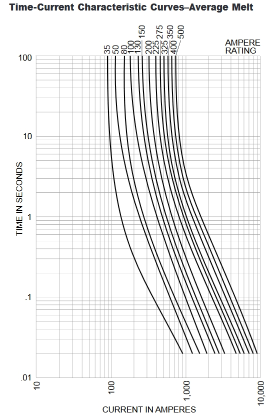

Current limiters are EXCEEDINGLY robust for their
'current carry ratings' . . . A 50A limiter will
carry 90A indefinitely. But opens in about 300
milliseconds with a 200A load.
[img]cid:.1[/img]
The battery-sources hard fault will be hundreds of
amps . . . the current limiter will open very quickly
while being immune to nuisance trips for normal, expected
operating conditions.
[img]cid:.0[/img]
[img]cid:.1[/img]

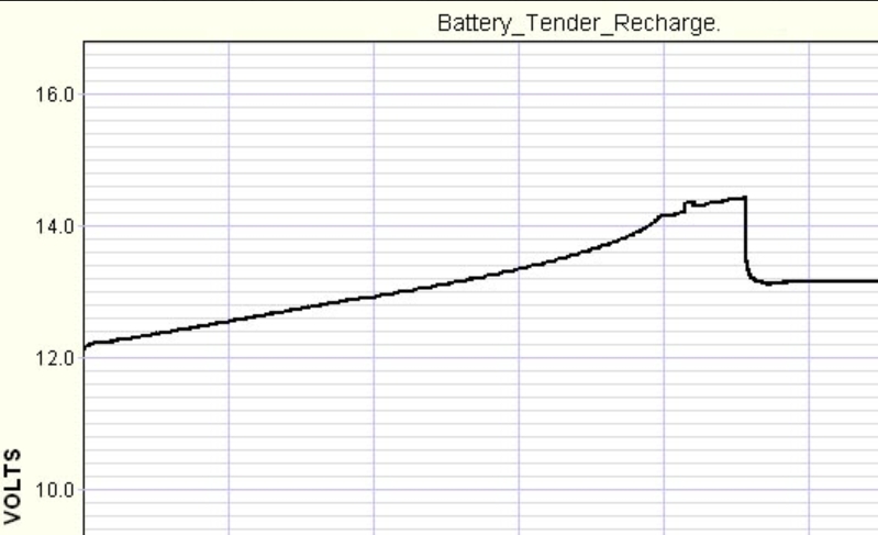

As Joe said, 14.x volts applied to a fully charged battery will result in virtually no current flow into the battery. But the same 14.x volts applied to a nearly dead battery will likely result in close to full available current from the alternator into the battery.
A lead-acid battery, fully charged, sitting at room
temperature presents an open circuit terminal
voltage of about 13.0 volts. Applying an external
source at slightly above 13.0 will not charge the
battery (i.e. convert the state of its chemistry)
but it will SUPPORT any self discharge currents
inherent in the physics of ANY lead-acid battery.
This is what a maintainer does . . . got a couple 100a.h.
batteries in the shop right now. One sitting on Battery a
Tender showing a green light (charged), it measures
13.11 volts; the other sitting open circuit for the past
week, it measures 12.88 volts.
A deeply discharged battery floated on a 13.8v charger
will eventually accumulate a charge at or near 100% of
rated capacity . . . it might take weeks. For example,
the two batteries cited above were purchased in July
and installed in a friend's John Deere road grader . . .
two 100a.h. batteries in series for 24v system.
I became aware that the grader had not been used in
several months. Went out to his ranch and absconded with
both batteries. Just for grins, I put them both on Battery
Tenders (0.75A charge rate). It took about a week
for the BTs to show a green light . . . but they DID
ultimately boost the batteries tot he 14.4 or so
volts that causes the BT to transition from CHARGE
to MAINTENANCE.
[img]cid:.0[/img]
I am pleased to suggest that the little Battery Tender Jr. should
not be discounted as a useful charge/maintenance tool for just
about any size battery. Oh, yeah . . . the plot above was measured
as an exemplar BT recharge profile . . . it was not taken on the
batteries cited.
  to MAINTENANCE.
[img]cid:.0[/img]
  batteries cited.
