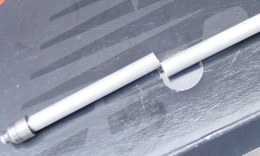

this pic is of a factory sub part in a Stratus conversion with solid lifters

Might give Stratus a call, do believe they replaced the stock push rods.

already talked with stratus and they said they use the stock parts. I
replaced it with a stock part from the auto parts store. I was just
wandering what the NSI parts look like and if they are stronger.

Lance once told me they use the stock pushrod ends however they replace the actual rod with an aluminum rod.
