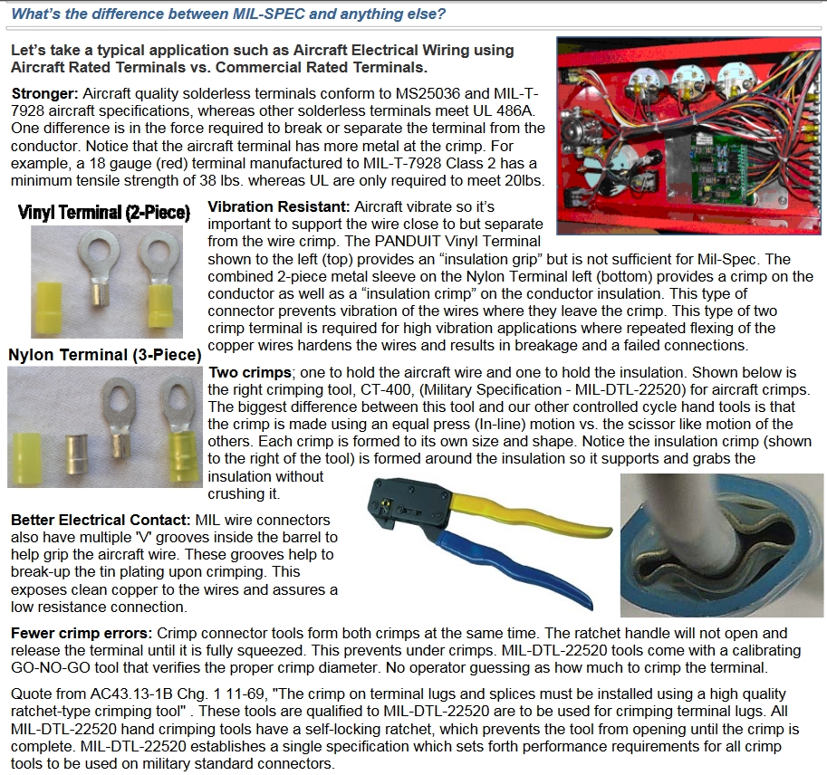

PostPosted: Wed Apr 04, 2018 7:41 am    Post subject: insulation support for crimps Reply with quote
At 05:18 PM 4/3/2018, you wrote:
It’s not something you’ve specifically recommended: google for “krimptite” and you’ll see some examples of to what I was referring.
Okay. Found this .pdf that speaks to the
spectrum of Waldom termnials
https://goo.gl/XKMA71
The generic Krimptite devices are the bottom
of the features ladder. No insulation grip,
rolled, non-welded wire grips.
Next step up through the product line adds
insulation grips to the non-welded
terminals.
Next are uninsulated but more robust terminals
specifically designed for solid wire and wire
grips intended for facilitating 'pulls' of
wire thorough a conduit. Stationary applications.
Next step up are the AviKrimps . . . the Molex
offering to higher performance vehicular
applications (like airplanes). These are equivalents
to Tyco-Amp PIDG, Panduit PN series and others
designed to the spirit and intent of M25036/T7928
The next steps up the ladder are pretty self explanatory.
There's a 'high temperature' version of the un=insulated
ring terminals designed for use in products like heaters,
ovens, furnaces, etc where even companion wires are
expected to stand off extra ordinary environmental
temperatures . . . temperatures too high for legacy
insulation grips but un-necessary since the terminals
are not expected to perform under vibration.
One does not save much money with the use of terminals
outside the bubble of M25036/T7928 products. The uninsulated
Krimptite devises would reside outside that bubble.
Here's a quick run-down on acme of terminal technologies
with about 80 years of history on aircraft and similar
applications.
[img]cid:.0[/img]
 Filesize:  928.9 KB
 Viewed:  11599 Time(s)

PostPosted: Thu Apr 05, 2018 1:21 pm    Post subject: insulation support for crimps Reply with quote
HI Bob
> M25036/T7928
What are these?
A
On Apr 4, 2018, at 11:40 AM, Robert L. Nuckolls, III <nuckolls.bob(at)aeroelectric.com> wrote:
terminals.
applications.
<973ee6.jpg>
 terminals.
 applications.
<973ee6.jpg>
applications.
<973ee6.jpg>
