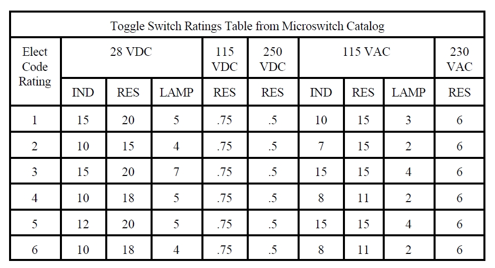

Here'a a general article on switch rating
as it relates to our use of them in airplanes.
https://goo.gl/CPtPYJ

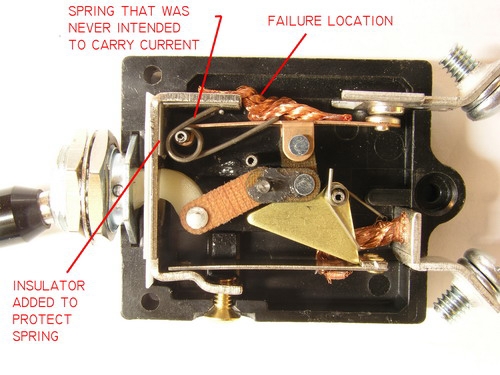

Good move . . . but not necessarily useful for
all switches. Barons and Bonanzas suffered a rash
of switch/breaker failures wherein a flexible braid
of fine wires intended to carry controlled
current around the pivot point to the front frame
of the switch.
This forced current to flow through the
spring. The 30A Prop Anti-Ice breaker
switch was observed to emit streams of
smoke past the toggle as the spring turned
into a heater.
[img]cid:.0[/img]
This single case prompted a kerfuffle suggesting
that ALL the switches be replaced when in fact, the
prop deice was the only high current situation that
would smoke the spring.
Similarly, the Carling switches as-received are
just fine for the purposes to which we might use
them while keeping an eye on the switch controlling
high energy strobes. It would probably be good
practice not to run such strobes on the ground.

The device's ability to MAKE and BREAK a
circuit is another matter . . . and indeed
is influenced by the nature of system
voltage. This is explained in an article
I published at:
http://aeroelectric.com/articles/Switch_Ratings.pdf
A study of the published ratings from Honeywell
literature supports the notion that the 125VAC
ratings of commercial, off the shelf switches
are on a par with the switch's 14VDC ratings.
Hence my advice to builders over the years suggests
that a hardware store switch rated for 10A at
125VAC was suited to operation in an airplane
at 14VDC.

  Here'a a narrative that goes to a particular
  kind of failure in the Carling swtiches:
https://goo.gl/oiZjeG
  I've done teardowns on about a half dozen
  switch failures with locus of the failure
  was seldom repeated.

What do you consider "on a par with..." One can go to just about any electronics catalog and look up a switch with dual ratings and you will ALWAYS find the DC Amperage is lower than the AC Amperage of that same switch.
What statement in the article I cited was questionable?
Did you read the article?
I cited a ratings chart purloined directly from the Honeywell/Microswich
catalog which I repeat here:
[img]cid:.0[/img]
I observe that for a switch with any particular
"electrical code rating" the 115 VAC ratings are
not seriously different from 28VDC ratings. I further
deduced that 14VDC ratings should be equal to or better
than 28VDC ratings.
Consider a switch of code 3:
115 vac resistive 15A
28 vdc resistive 20A
Why would such a switch not be comfortably incorporated into
a 14VDC system working a 20A load?
Take any OTHER rating and cite the situation where the
builder's choice of switches is at-risk for using the
device?
Further, assume that a switch is incorporated into
a 14VDC system at say 3x the switch's 'ratings'.
What are the likely effects for such oversight?
How would a 3x 'overload' affect service life? Given
that most lightplanes fly 50 hours per year, assiming
two switch operations per flight hour, what might we
expect for service longevity of this 'severely' overloaded
switch?
Forgive me, that's a loaded question. Referring to the
the chart above, the 'severely overloaded' switch would
would have to be applied in a circuit that controls at
least 15 x 3 or 45 amps. No such system exists in light
aircraft where such currents flow in crew operated switches.
The point to be considered here is that the 'warm switch'
in question has an easily deduced root cause based on
simple physics and the extensive experience base for
members of this List.

ChasB(at)satx.rr.com
PostPosted: Thu Apr 05, 2018 6:22 am    Post subject: Warm Toggle Switch Reply with quote
Time: 08:45:12 AM PST USFrom: "Robert L. Nuckolls, III" <nuckolls.bob(at)aeroelectric.com (nuckolls.bob(at)aeroelectric.com)>Subject: Re: Warm Toggle SwitchAt 09:21 AM 4/4/2018, you wrote:
I went through several warm, hot, and/or shorted switches that operated my strobes. Tried several brands of switches all with the same results. Finally trouble shot the whole system and found a bad connector crimp on the positive wire that connected at the strobe power pack. Repaired same, and haven=99t had a switch problem since.
What were your observations for condition of the materials at the failure . . . and do you recall whether the failure was related to materials, installation technique or perhaps both? You mentioned 'shorted' switch . . . were you the builder who was experiencing fuse popping when the strobes were turned OFF? Bob . . .
Bob, et., al.,
I did have a popped fuse or so, but I don’t think they were related to the shorted switch. The shorted switch toggle itself was electrified when either on or off. On various switches, I found loose connectors, corroded and failed contacts, and in one case, the plastic switch case was partially melted from the heat. Failures were probably related to both materials and installation technique. I’m not sure all the problems were related to the bad strobe pack connection, but fixing that seems to have solved the problems.
Charlie
RV-6A, N11CB
San Antonio
BARRY CHECK 6
Joined: 15 Mar 2011
Posts: 738
PostPosted: Thu Apr 05, 2018 7:31 am    Post subject: Warm Toggle Switch Reply with quote
Good Find Charlie;
Sure sounds like your switch did one of two things or maybe even BOTH:
1 - WELDED the contacts closed and/or,
2 - Mechanically Failed.
The mechanical failure could also have been due to the contacts being Welded and when you flip the switch, the weld being stronger than the pivot points of the switch...  Ergo, the switch broke!
Question:  Is the switch WHITE in color?  Except for the burnt areas of course?
Poor contact(s) ANYWHERE in the circuit increase current draw. The weak point being the switch.
ARKENSPARK  - - ARKENFARK
Hope my original post was helpful.
Barry
On Thu, Apr 5, 2018 at 10:21 AM, Charles Brame <ChasB(at)satx.rr.com (ChasB(at)satx.rr.com)> wrote:
Bob, et., al.,
Charlie
RV-6A, N11CB
San Antonio
