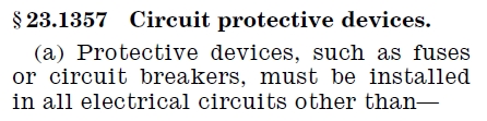

PostPosted: Fri Jun 29, 2018 7:08 am    Post subject: Z-14 Question Reply with quote
On 6/29/2018 8:46 AM, Rocketman1988 wrote:
Kelly,
Thanks for your opinion. I hesitate posting on these forums due to the “nay sayers” when anything other than the simplest tech from the 50’s is suggested. I have chosen to use a full EFII system and fully accept the additional complexities. I do appreciate your insight on things...
As for the previous post about the B lead current limiters, I would disagree with putting the fuse at the other end as that would place it between the battery and starter.
I guess I should have been more specific. The other end of the *wire*;
not the entire path. Look at the wire protection for the main alt, which
is at the hot side of the starter contactor end of the 8 ga wire
(correct). Now look at the protection on the aux alt B lead, at the
alternator end, instead of at the source end, which is the cross-tie
contactor.
When I took another look for this email, I also noticed that the 8 ga
wires feeding both fuse blocks don't have any protection. 'Conventional
wisdom' is that the battery contactor protects the 'fat wires', but
smaller wires need protection.  What I see is 2 ga wires stepping down
in size to 8 ga wires, with no switching (disconnect) and protection at
the start of the 8 ga wires.
That's not a problem, as long as there isn't a problem. Smile
Charlie
https://www.avast.com/antivirus
ceengland7(at)gmail.com
PostPosted: Fri Jun 29, 2018 7:17 am    Post subject: Z-14 Question Reply with quote
Protection devices are to protect *wires*. In our aircraft environments the source of damage to wires is always the battery. Alternator B leads should be sized big enough to handle the max that the alternator can deliver, so they need no protection from the alternator. But the battery can deliver hundreds of amps (sometimes *many hundreds* of amps). The 4 ga and larger stuff can survive long enough to use the master contactor as protection, but smaller stuff runs a big risk of lighting up the insulation if there's no circuit protection.
No protection device on a wire is there to protect the battery.
Charlie

In the case for your intended bus feeders, it is sufficient
to route, support and otherwise eliminate probability
of a soft fault (like rubbing an elevator cable or vibrating
against the EDGE of a lightening hole in a bulkhead).
The FAA acknowledges the unique fault probabilities
of fat wires with words that speak to the design
of light aircraft:
[img]cid:.0[/img]
[img]cid:.1[/img]
Your proposed fat wires fall under
clause (2).

Sooo...I do NOT need to use an ANL fuse on those 8AWG battery feeders...
Correct?
PostPosted: Sun Jul 01, 2018 1:42 pm    Post subject: Z-14 Question Reply with quote
At 02:34 PM 7/1/2018, you wrote:
--> AeroElectric-List message posted by: "Rocketman1988" <Rocketman(at)etczone.com>
Correct?
yes
