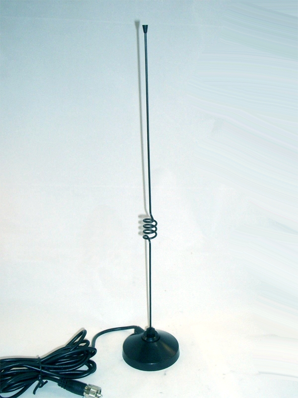

Bob,
About "portable" 121.5/406 antennas....
I would like to construct a portable antenna that in the event of surviving a mishap, one could remove the ELT, take outside to a favorable location, connect the portable antenna and have a better chance of being found earlier.
I know this is a dual frequency design, but it has been too long since I studied and made lower frequency antennas, so I am asking if you could suggest a construction design.
I believe the 406 part should be cut for 3/4 wavelength, but the loading coil size and position for the 121.5 is vague. I am assuming about 1/3 up the whip so as to not interfere with the max. current wave point of the 406 signal.
Also, should the whip have a small circular ground plane attached to the BNC connector on the base.?
If you have ideas on this little antenna, I would very much like to view them.... Dave

PostPosted: Fri Aug 17, 2018 8:01 am    Post subject: elt antenna - Question for Bob Reply with quote
At 10:14 AM 8/17/2018, you wrote:
Bob,
[img]cid:.0[/img]
It would be interesting to get a lessons-learned dump from
an antenna expert . . . anyone else out there with additional
input?
I presume antennas like this one start with a 1/4 wave at
highest frequency of interest, add a loading/trap coil
at the top tailored to resonate at 406 with the parasitic
capacitance afforded by the radiators attached at each
end, then trim the top segment for best match at lowest
frequency of interest.
No doubt the resonance effects are interactive so it
would take some fiddling to optimize the design. Obviously,
an oversized 'hand held' is not an idealized ground plane
so should the optimizing studies be done using a rough
mock-up of the ELT's 'ground plane' signature.
I've got a new vector network analyzer that I've not
taken out of the box yet . . . too many irons in the
fire. But I'm hoping the tool will open some new windows
on my bag of tricks . . . the only thing I really miss
about my tenure at Beech was access to that RF lab!
I think that given the 'dire straits' of conditions
that would prompt hand-held operation, I'd build
a 406 quarter wave on a coax connector and call it
good. As others have pointed out here, the ability
of the 406 satellites to sniff out a weak signal
is really good. If you're out on the ground with
a 406 device in your hands, the 1/4 wave whip is
going to get the performance you need.
