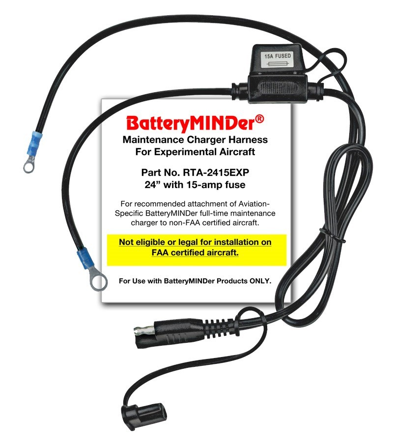

I have a Battery Minder with the connector provided. I would like to change to something I can mount to the airframe that will allow connecting with one hand.
Anyone have any suggestions?

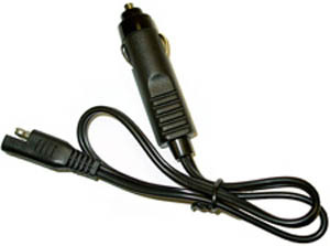

I have a Schauer CM6A charger feeding an Odessey PC680 through an aux power (cigarette lighter) socket through an adapter plug such as this:
https://www.atbatt.com/battery-tender-081-0069-5-cigarette-adapter-quick-disconnect-black/?gclid=EAIaIQobChMI9vGZwvDE3QIVjbXACh3p6A47EAQYEiABEgJiY_D_BwE
The aux power socket is wired to the always hot battery bus. Thus I can charge the battery even when the main bus is off.
This Schauer charger is set to deliver a 4 amp charge to a depleted battery. It then automatically tapers down to a maintenance level. Works for me. Maybe this would work for you if you have an aux power socket.
Eric

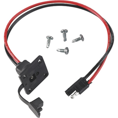

BatteryMINDer EZC-01 Universal Flush-Mountable EZ Connector - with 4 Mounting Screws
$15 on Amazon

PostPosted: Sat Sep 29, 2018 4:26 am    Post subject: Re: Battery Minder connector Reply with quote
$15 on Amazon
Bingo!!!
Thanks Moose!
