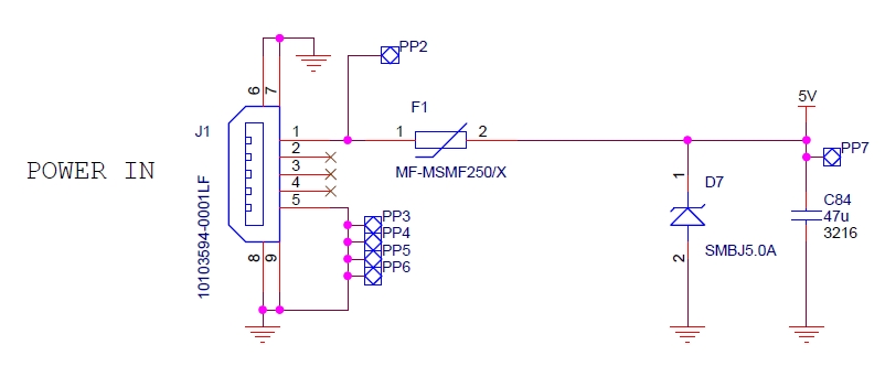

As a side note, I observe that the RPi designers seem
rather fond of the SMBJ5.0A transient suppressor as a
hedge against o.v. condition at the input terminals to
their product.
[img]cid:.0[/img]

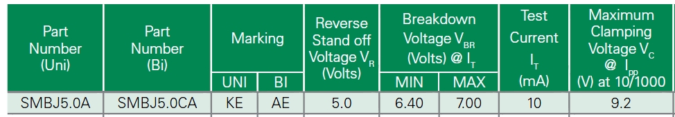

This is a GROSS MISAPPLICATION of these devices. Specifications
for this device tell us . . .
[img]cid:.1[/img]
These devices BEGIN to conduct at 6.4 to 7.0 volts.
When subjected to fault currents up to an including the
device's peak power rating of 600W, they may clamp-off
the supply voltage at 9.2 volts or so.
The RPi will be toast at considerably less voltage. The Transorb
is designed to stand off fast rise, relatively short transient
events . . . not hard regulation failures in the input supply.
Further, the equipment they are intended to 'protect' must
stand off an over-shoot greater than or equal to the
clamping voltage of the protective device.
Virtually ALL of the commercial, off-the-shelf down-converter
products have a failure mode that includes application of
ship's bus voltage to the 5.0v output rail . . . with an
impressive peak fault current.
If anyone is interested in applying a COTS down-converter to
their RPi (or any other system with a 5.0v operating bus),
I can offer an ov protection system that far exceeds the
capability of the SMBJ5.0A transient suppressor.
