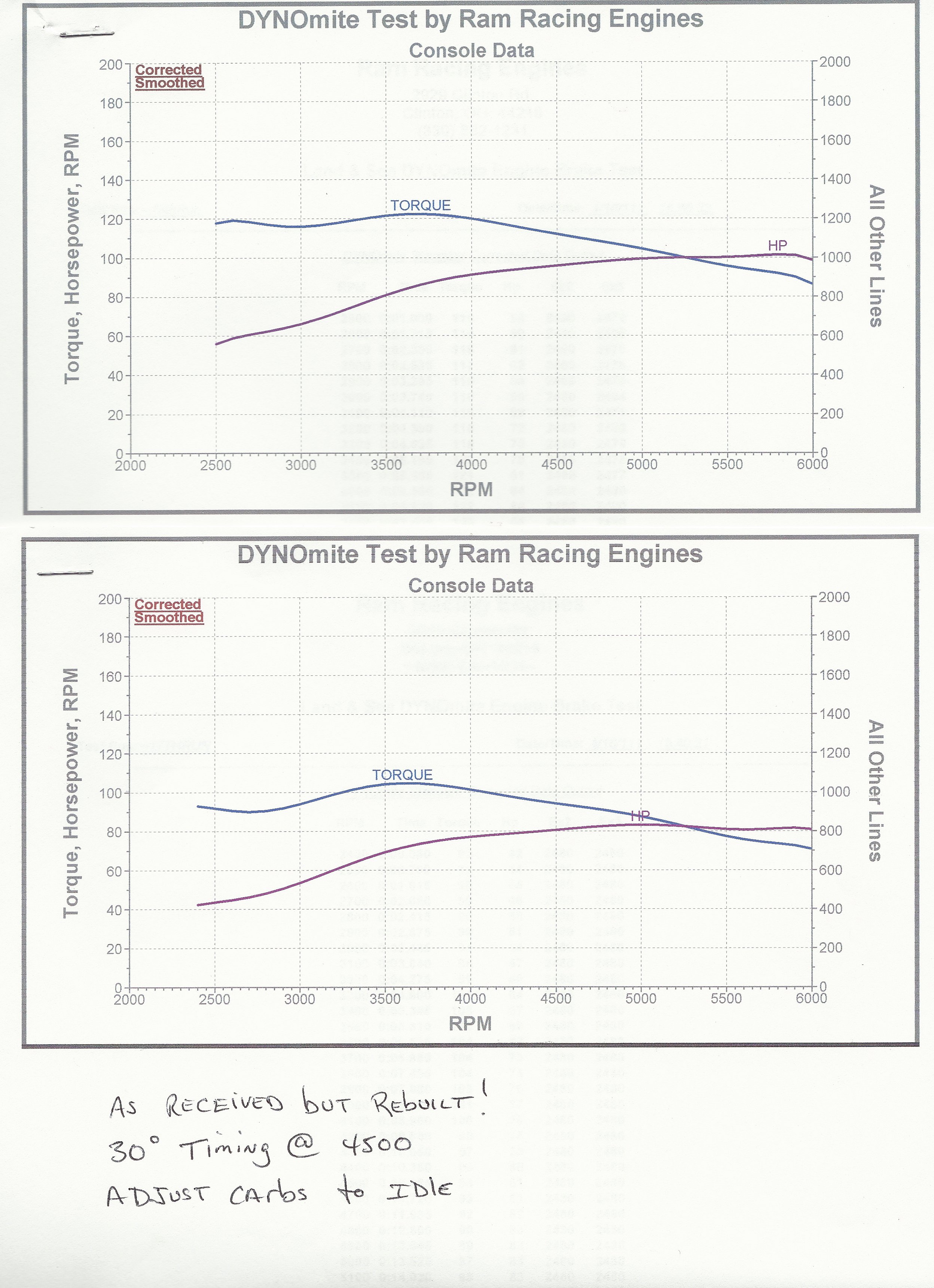

Trey,
Here are some dyno results I had done back in 2011.  The lower HP one is how my Stratus-built EA81 worked from Stratus and how I flew off my initial 40 hours.  That flying was done before the dyno and although I had far less than 100HP available, I was able to achieve decent results in testing on my Zenair 601HDS at max gross weight of 1320#.  Not stunning, but okay.  The engine ran like a top.  I had some cooling issues that took many flights to work out.....or so I thought.
I had a valve failure on the ground and sent the engine to Ram Performance in South Carolina.  He said I had very uneven fuel distribution due to the Stratus carb design.  He fixed the engine and put in spacers between the carbs and the heads that he had worked to develop.  After that work is what the second dyno chart represent.  He said he re-timed the engine and that Stratus's timing specs are wonky and that's the main reason for the HP increase.
Once the engine came back with more HP, I gradually increased the prop pitch and operated 100+ hours using about 4800 RPM for take off.  It still exceeded the performance from before the repair and the lower RPM was still giving me almost 100HP on takeoff.  The higher prop pitch increased cruise.  In cruise at full throttle, the RPM sometimes went to about 5000.  Still well below Stratus redline.  I also liked the "non-screaming" aspect of the lower RPM.
But the saga continues.  About a year ago I was ground testing the Stratus secondary electronic ignition and it malfunctioned.  It started firing completely out of sequence.  As it bucked to a violent stop it cracked two engine mounts, so here we go again.  I sent it back to Ram and he said the engine was not damaged by the ignition event, but that I had excessive wear on the front cylinders due to "fuel washing" from, again, uneven fuel flow from the Stratus carb setup.  Ram (Ron Carr) no longer messes with carbs due to this and he convinced me to have him install fuel injection and electronic ignition.  I just got the engine back and have many hours of work to finish the installation.  He ran a dyno test on the new setup and it maxes out around 108HP.  I haven't scanned that result yet to attach.
All this aside, the key thing to achieve before attempting flight is to ensure you have a prop within all design specs (e.g. pitch and diameter) turning within design RPM specs.
Good luck with your project.
Ron Hansen
Los Angeles

Ron, thanks for the response. Lot of good information. You have certainly had your hands full.
As to my prop, It's a 3-blade Warp Drive, 72 inch diameter, set to 11 degrees pitch which is what the company recommends. Still have to teach the blades to see what rpm they are turning at the 5000 engine rpm. That's  a project for next week.
Trey
Ron Hansen
Los Angeles
[img]content://com.samsung.android.email.attachmentprovider/2/1677/RAW[/img]

ronhansen123(at)gmail.com
PostPosted: Thu Oct 25, 2018 8:58 am    Post subject: static rpm Reply with quote
Best of luck with everything.
Ron
increase.
