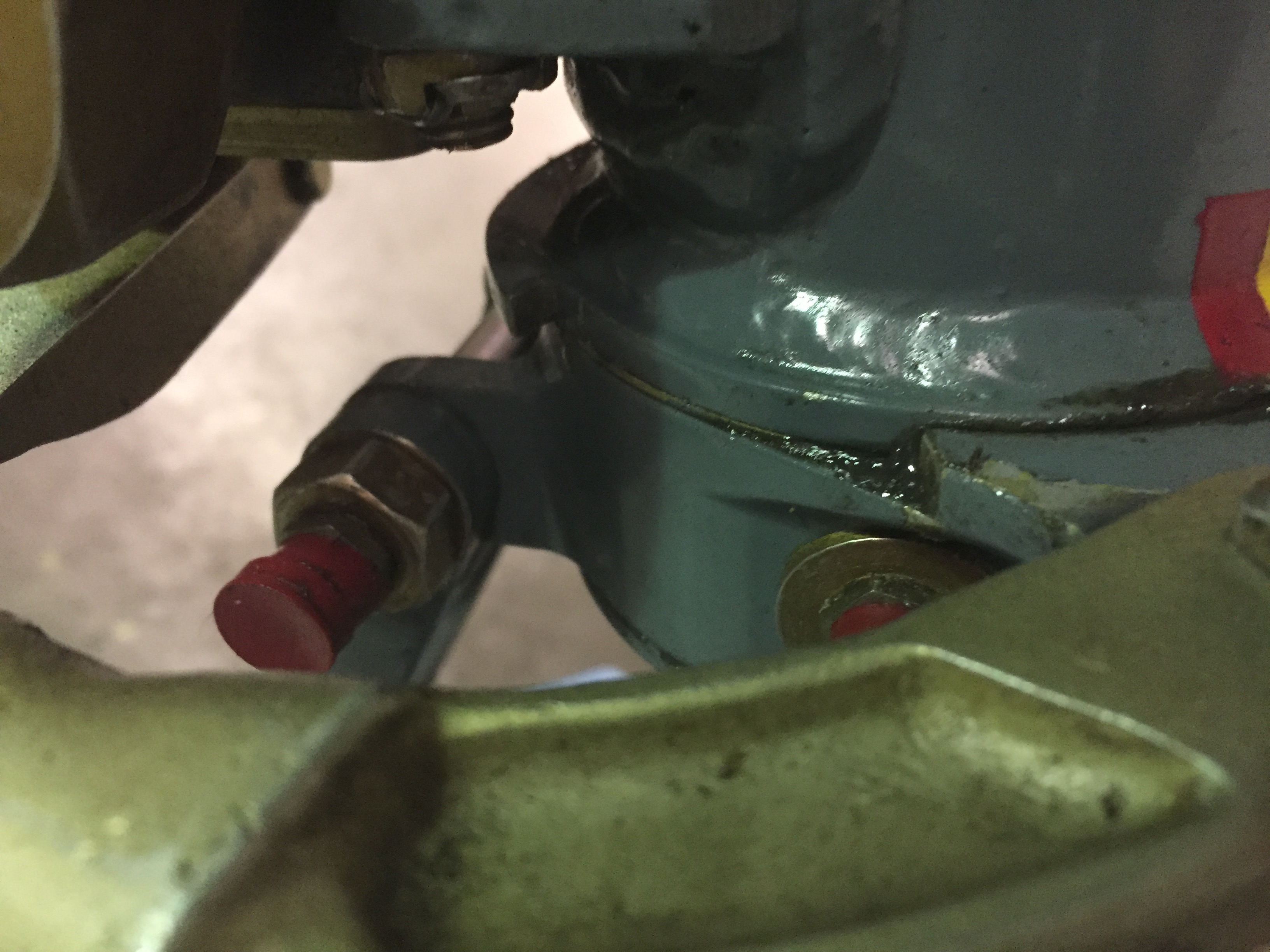

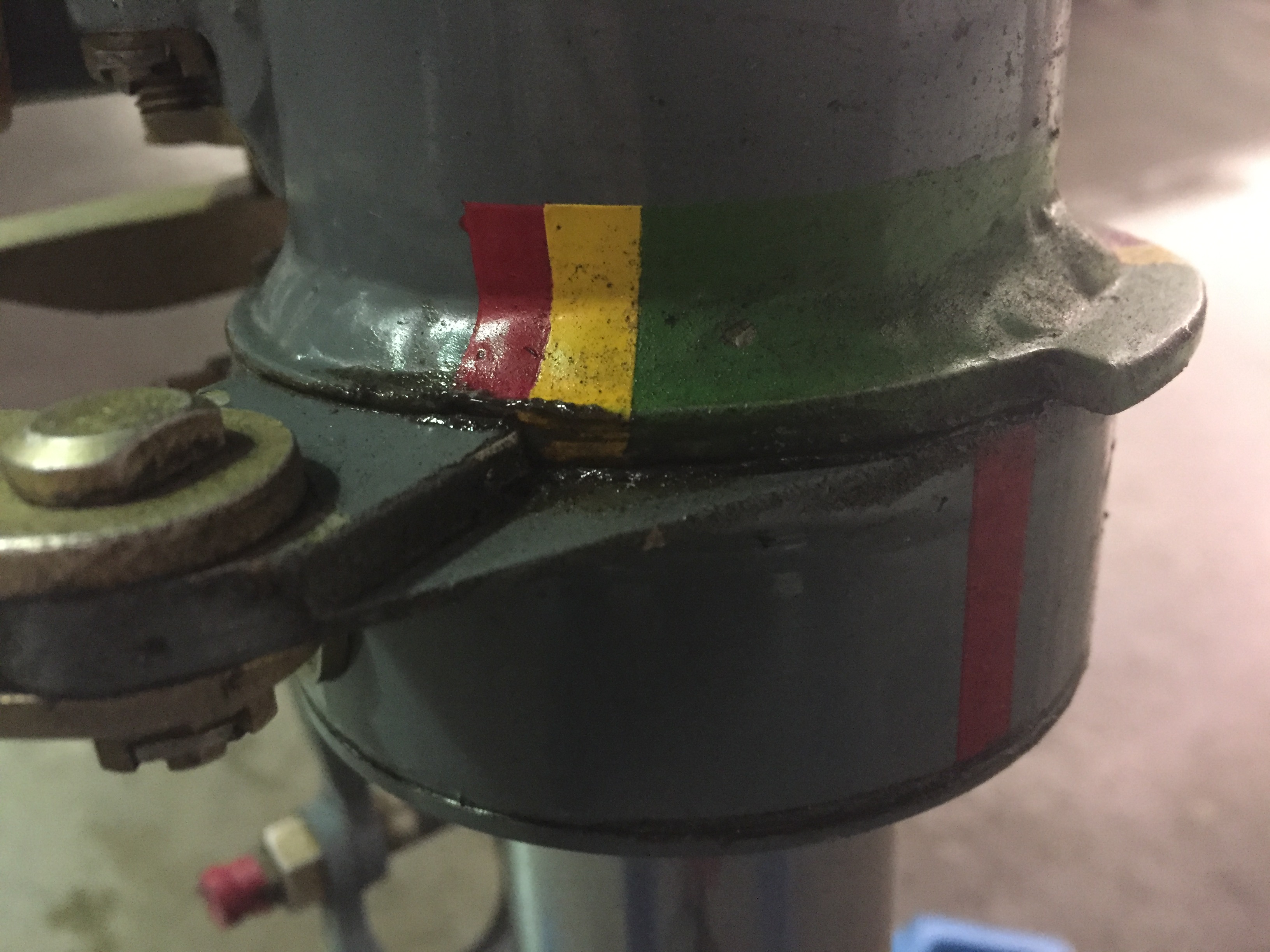

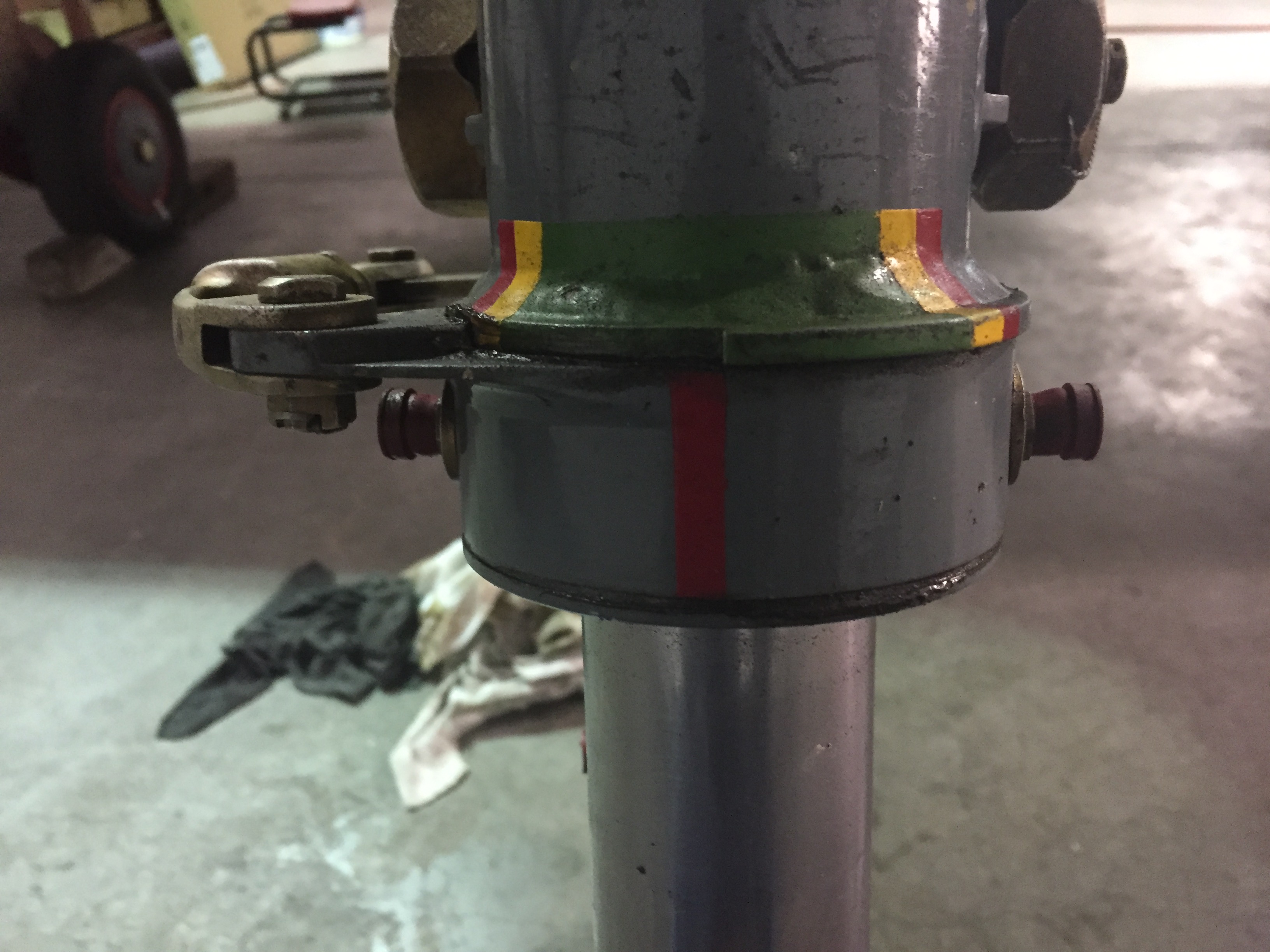

PostPosted: Wed Oct 31, 2018 9:02 pm    Post subject: Tug or tow bar for the CJ6? Reply with quote
Sorry for the lousy photos. Too damn old for smart phones & computers.
Photo 1; Front view of strut, rotating collar and stop lug.
" " 2. RH view of LH turn fixed stop (FWD).
" " 3. RH view of RH turn fixed stop (AFT)
The rotating collar of course is attached directly to the wheel fork and
inner strut through the scissor links. If the forced turn with a tug is
carried to stop contact (red on red) in either direction any further turn
will break something.
Walt
