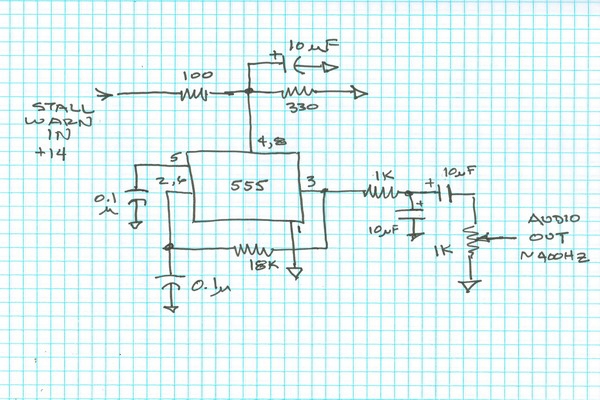

PostPosted: Sat Dec 01, 2018 12:48 pm    Post subject: Stall warning through Radio Reply with quote
At 08:50 AM 12/1/2018, you wrote:
Those do-it-yourself kits require that aircraft voltage be reduced, perhaps to 5 volts.
[img]cid:7.1.0.9.0.20181201144640.0208eff8(at)aeroelectric.com.0[/img]
How about this?
 Filesize:  191.81 KB
 Viewed:  10398 Time(s)
user9253
Joined: 28 Mar 2008
Posts: 1978
Location: Riley TWP Michigan
PostPosted: Mon Dec 03, 2018 2:35 pm    Post subject: Re: Stall warning through Radio Reply with quote
There are lots of ways to make an alarm tone.
The Forrest Mims Engineer's Notebook (my favorite book) has some circuits.
https://www.zpag.net/Electroniques/Kit/The%20Forrest%20Mims%20Engineers%20Notebook.pdf
On page 55 is a gated tone source. Grounding a pin on a 74LS368 turns on the tone.
Joe Gores
PostPosted: Mon Dec 03, 2018 2:52 pm    Post subject: Stall warning through Radio Reply with quote
Boy . . . there's a classic. I've recommended
that publication dozens of times over the years.
An excellent learning tool.
