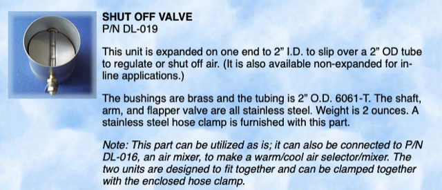

After reading the comments I'm wondering about making a removable
restrictor/air dam in front on the scat tube. Normally need very little heat
in Arizona although last winter in Missouri max heat was needed on very cold
days. I guess one could make a shutter like dam that could be operated from
the cockpit as opposed to having to remove the top cowl. I installed a
sliding restrictor to block heat on my side in the cabin since my wife
usually wants a lot more heat than I do.

Here is a possibility.
[img]cid:44A92444-D7BB-42D1-9F4A-312408CB7276(at)flbb.net[/img]

I just use aluminum tape and cover about 1/3 of the inlet in the baffle.
It’s easy to remove when you want full flow.
