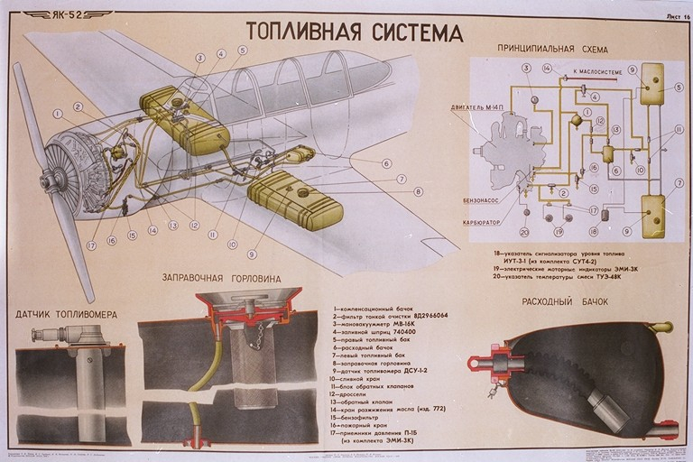

Walt has definitely pointed you in the right direction. When inverted, the Yak 52 including the TW, has a flop tube inside the header tank that "flips" over when the aircraft is inverted. Fuel is never fed directly from the fuel tanks in the 52's. It's always fed from the header tank. Actually, "fed" is not a proper term. It is consumed from the header tank. The fuel tanks refill the header tank.
Do you know why the Yak 52's are limited to 2 minutes inverted flight? It's because of the capacity of the header tank.
Since it's a TW, the flop tube in the header tank is not as old as the original 52's.  But it is a flexible hose inside the header tank. If the flop tube is or has becoming brittle, maybe the flop tube is not functioning as it should. So don't discount this as a potential cause of what you experienced Quite honestly, the flop tube is THE most neglected flexible line in a Yak 52. I'm sure you can see why.
I'm attaching a cut-a-way drawing of the 52's header tank. Look at the lower right side of this original Russian training placard where you can see the flop tube. (Yes, the placard is of an original Yak 52. But the header tank is the same.)
[img]cid:22f45f35-4abe-579d-ff72-a319f91be345(at)yahoo.com[/img]

 Filesize:  343.58 KB
 Viewed:  19295 Time(s)

I know many will give opinions on the asymmetrical fuel flow, but that's not the question... the header tank is the question. And for those who want to tell me about setting proper trim, I've got the trim tabs well balanced, but still have to "step on the fuller tank" to get it back to "30-30" in both tanks. Help me understand the header tank thing and we can talk about trim later please.
Jon Blake
Saber369(at)comcast.net
> On December 13, 2018 at 12:59 PM Mark Davis <markdavis(at)wbsnet.org> wrote:
> What everyone is possibly not considering is that the flop tube is held in
> good fuel by either positive g or negative g. O g where the issue arose
> could have the flop tube out of the fuel if sustained for a long enough time
> of the hose is becoming somewhat stiff.
> Mark Davis
> N44K
PostPosted: Thu Dec 13, 2018 2:52 pm    Post subject: Yak 52TW Fuel Starvation at near zero G Reply with quote
Thanks Dennis.
I'm thinking these "flapper" valves do not exist on the CJ. I say this because when I part my CJ on a slope fuel will drain from the upslope tank to the down slope tank.
Still leaving the question possed eariler about the header tank. JB
Sent from Xfinity Connect Application
pfstelwagon(at)earthlink.
PostPosted: Thu Dec 13, 2018 3:09 pm    Post subject: Yak 52TW Fuel Starvation at near zero G Reply with quote
They are there they have to be looked at occasionally as they will stick open or closed. They get ignored because it is not easy to check them. They are not absolute like the air system check valves they will leak.
Frank
[quote] On Dec 13, 2018, at 2:51 PM, JON <Saber369(at)comcast.net> wrote:
Thanks Dennis.
pennington.construction.i
PostPosted: Thu Dec 13, 2018 3:58 pm    Post subject: Yak 52TW Fuel Starvation at near zero G Reply with quote
What is the purpose of the valves in the header tank.
Could you remove them?
Mark Pennington
On Thu, Dec 13, 2018 at 6:15 PM Frank Stelwagon <pfstelwagon(at)earthlink.net>
Frank
> Thanks Dennis.
PostPosted: Thu Dec 13, 2018 4:08 pm    Post subject: Yak 52TW Fuel Starvation at near zero G Reply with quote
They are there to prevent cross feeding, not always successfully. I wouldn’t remove them.
Frank
On Dec 13, 2018, at 3:57 PM, Mark Pennington <pennington.construction.inc.1(at)gmail.com (pennington.construction.inc.1(at)gmail.com)> wrote:
[quote]What is the purpose of the valves in the header tank.
Mark Pennington
On Thu, Dec 13, 2018 at 6:15 PM Frank Stelwagon <pfstelwagon(at)earthlink.net (pfstelwagon(at)earthlink.net)> wrote:
[quote]--> Yak-List message posted by: Frank Stelwagon <pfstelwagon(at)earthlink.net (pfstelwagon(at)earthlink.net)>
Frank
> On Dec 13, 2018, at 2:51 PM, JON <Saber369(at)comcast.net (Saber369(at)comcast.net)> wrote:
> Thanks Dennis.
bwade154(at)yahoo.com
PostPosted: Thu Dec 13, 2018 5:15 pm    Post subject: Yak 52TW Fuel Starvation at near zero G Reply with quote
I would have to say the valves are there (in a Yak) to prevent fuel in the header tank from flowing to the wing tanks when inverted.
On ‎Thursday‎, ‎December‎ ‎13‎, ‎2018‎ ‎07‎:‎20‎:‎10‎ ‎PM‎ ‎EST, Frank Stelwagon <pfstelwagon(at)earthlink.net> wrote:
FrankSent from my iPhone
Mark Pennington
[quote]--> Yak-List message posted by: Frank Stelwagon <pfstelwagon(at)earthlink.net (pfstelwagon(at)earthlink.net)> They are there they have to be looked at occasionally as they will stick open or closed. They get ignored because it is not easy to check them. They are not absolute like the air system check valves they will leak. Frank Sent from my iPhone > On Dec 13, 2018, at 2:51 PM, JON <Saber369(at)comcast.net (Saber369(at)comcast.net)> wrote: > > Thanks Dennis. > > I'm thinking these "flapper" valves do not exist on the CJ. I say this because when I part my CJ on a slope fuel will drain from the upslope tank to the down slope tank. > > Still leaving the question possed eariler about the header tank. JB > > > Sent from Xfinity Connect Application > > --
PostPosted: Fri Dec 14, 2018 3:43 am    Post subject: Yak 52TW Fuel Starvation at near zero G Reply with quote
That is also true.
On Dec 13, 2018, at 5:14 PM, bill wade <bwade154(at)yahoo.com (bwade154(at)yahoo.com)> wrote:
On ‎Thursday‎, ‎December‎ ‎13‎, ‎2018‎ ‎07‎:‎20‎:‎10‎ ‎PM‎ ‎EST, Frank Stelwagon <pfstelwagon(at)earthlink.net (pfstelwagon(at)earthlink.net)> wrote:
Mark Pennington
Ttail
Joined: 24 Jun 2013
Posts: 122
PostPosted: Fri Dec 14, 2018 11:59 am    Post subject: Re: Yak 52TW Fuel Starvation at near zero G Reply with quote
Does anyone have an image of the exact location of the flapper valves in the CJ or even an image of the flapper valve itself ?
