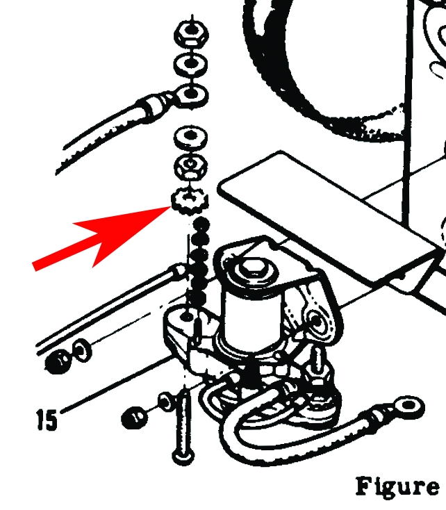

Just for grins, I checked a Brand-C parts
catalog for battery contactor installations
and found this image:
[img]cid:.0[/img]
Here we see a lockwasher called out as part
of the assembly. It's used under a nut that
secures a terminal post to the 'wing' of
an H6041 mil-style contactor. It doesn't
have a numerical call-out meaning its not
a cataloged spare part as far as Cessna
is concerned. In fact, it's part of the
contactor assembly as supplied by Cutler-Hammer
(item 15). I'm not sure why the catalog
illustrator chose to explode these parts
off the as-supplied assembly. From an OEM
service manual perspective, there was no
reason to disassemble that stud.
I also found some un-flagged star washers
on vendor-supplied assemblies but in each
case, the washer was under a nut . . . not
part of the current path. As a factory
policy, metal locknuts were the
preferred anti-loosening technology for
threaded fasteners.

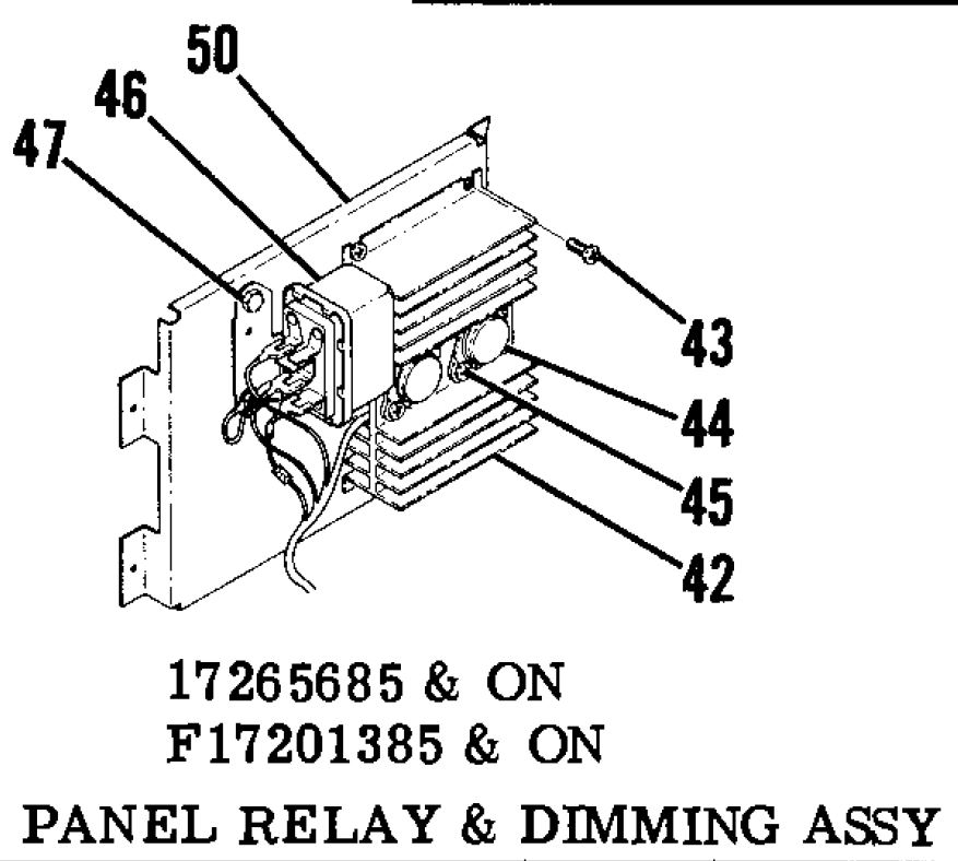

An interesting aside . . .
While cruising through the electrical installation
data I found this image I had forgotten
about . . .
[img]cid:.1[/img]
Somewhere in my archives, I have a letter from
the head-shed of single engine electrical systems
rejecting my proposal for replacing the too-warm,
panel dimming rheostats with a remotely mounted
array of power transistors on heat sinks. This
would have been about 1964 or thereabouts.
He offered a litany of down-sides . . .
A about 5 years later, the same idea cropped up
across town on the light twins . . . a short
time later, solid state dimming migrated into the
single engine airplanes. We COULD have beat
the twin engine line to this enhancement by
several years. Oh well . . .
