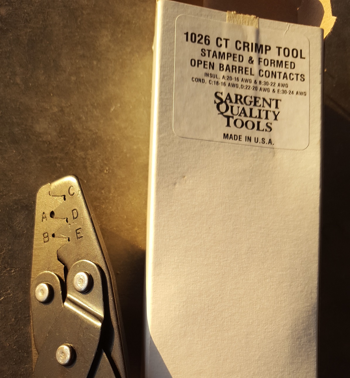

PostPosted: Sat Jan 05, 2019 11:22 am    Post subject: Re: Open Barrel Crimp Tools Reply with quote
Bob, here is a pic of the crimp tool I used. As I dug the tool out to take a picture, It dawned on me that I had used this on 14ga wires. The tool is not suitable for that size wire. So, it seems reasonable/likely that the crimps were not formed correctly. Bad crimp, high resistance, crispy wire...?
Dave
