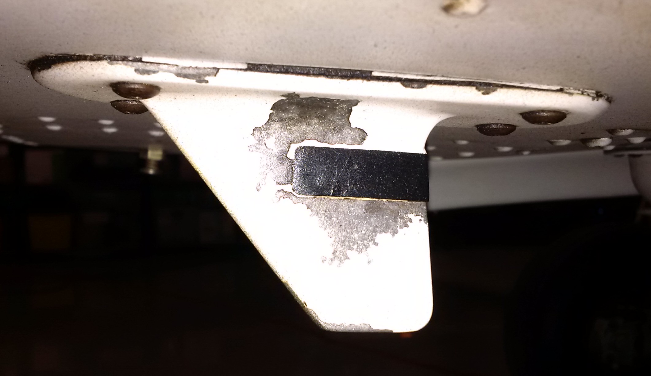

One thing I find odd about the blade transponder antenna, is that the entire body is a chunk of aluminum. There is a horizontal band with a plastic? covering. So it seems the radiating element is pretty shielded inside.
It is a Dorne & Margolin DM NI 70-2 if anyone is familiar with it.
Photo attached.
Jeff Page
Dream Aircraft Tundra #10

PostPosted: Fri Jan 04, 2019 5:42 am    Post subject: Transponder Antenna Reply with quote
At 03:52 PM 1/3/2019, you wrote:
--> AeroElectric-List message posted by: "Tundra10" <jpx(at)qenesis.com>
That whole chunk of aluminum above
the plastic insulator IS the antenna.

PostPosted: Fri Jan 04, 2019 7:33 am    Post subject: Re: Transponder Antenna Reply with quote
This would be easier for me to understand if the plastic insulator went all the way around.
It only goes halfway, so the aluminum at the tip of the antenna is the same solid chunk of aluminum as at the base, which is connected to the shield of the cable and the aluminum skin of the aircraft.
Jeff Page

PostPosted: Fri Jan 04, 2019 9:57 am    Post subject: Transponder Antenna Reply with quote
If only one side of the blade is insulated
then the antenna's feed-point is at the
center of the insulated side with
some form of matching not unlike
a 'gamma match' on a 1/4 wave vertical.
This allows the whole antenna to be formed
from a single piece of metal for mechanical
robustness, total ground at DC, yet presents
a 50 ohm load to the transmission line.
Antenna design and fabrication often seems
like magic . . . looking through the myriad
of patents can leave one in awe for those
to have mastered the art! Just did a quick
search on 'blade antennas' hoping that the
antenna under discussion might pop up . . .
https://tinyurl.com/ya24kfgu
good luck with that!
I think I've got some data on that design
buried around here somewhere. If I run
across the article, I'll post it.
