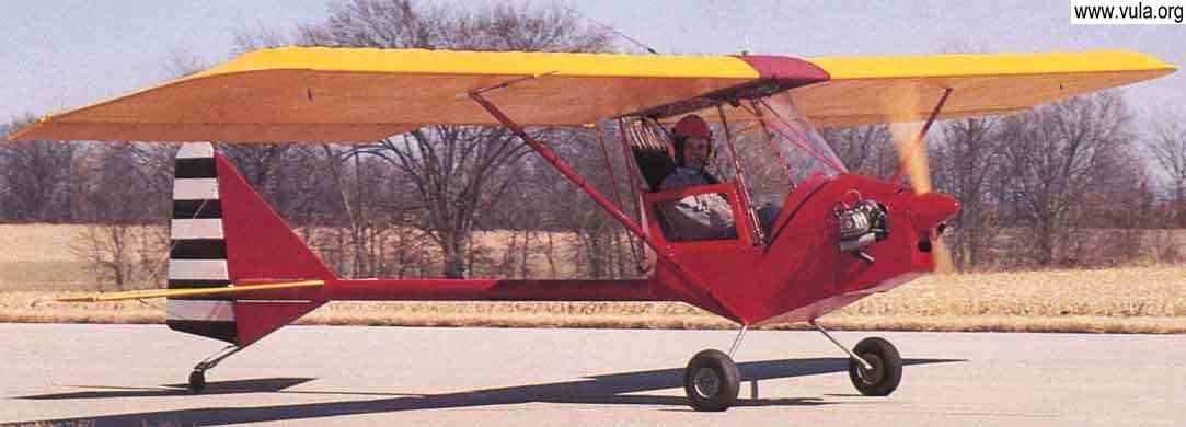

PostPosted: Sun Jan 20, 2019 12:59 pm    Post subject: Cost to scratch build Ultrastar airframe? Reply with quote
My thoughts, having owned and rebuilt an Ultra Star; Never flown...but am told that it is the best flyer of the whole Kolb stable..neutral thrust for one..Per Hauck...
for starters.very minimal fuselage..the Firestar gear is a definite good mod...the low to the ground prop is always in danger of nicks...the Cuyana engine was good for the time..but I am told that it tended to leak between the thin case halves..Electronic ign on the UL 202 , made for easy starts even being inverted. If I had another one, I might try large bicycle wheels to improve prop clearance. The fuel tanks worked but could be improved on today..
All in all...not a good plane to build these days...Likely many sitting here and there not flown for years...I would place a want ad on Barnstormers. $1000 dollars or more plus shipping for two wing spars makes me shiver...then again...so does the price of hamburger! Smile
I gave 1k for mine as a project...the cuyana engine is not worth much...very old...35 to 40 years old I think? The 377 or 447 should work. They are old too!! Hirth seems to have mended their reputation...so should be considered given that KOlb is using them..
I bought the Firestar II for 6k...with high time 503...and I do not doubt that you would spend as much building a US...
Two Fireflys sold on Barnstormers some time ago for 6 or 7k as I recall..for both..from the same seller...I could not get a picture before someone , more local beat me to them..Minnesota? but I would have paid shipping...and still have come out...A good Firefly with low time engine is worth 9 to 10 k in my book.
I have a boom tube, tail feathers and wings for a Firestar... I want to turn them into some sort of hybrid not unlike the US...but with a wooden fuselage..
Here is what can be done with a bit of imagination...Bill Bronson's Kolb parts used in a half vw tractor config...Herb

by now everyone knows I am tigh...er Frugal....I bought the yellow sling shot shown on the factory site for $6500 as I recall...High time 582.
I say...simply..bide your time and buy used..near a third of the price of new many times.. Covering is simple on Kolbs and reasonably cheap and a good way to do value added...
