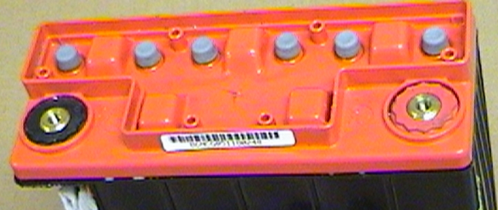

I’m working with my engineering representative to modify a TC aircraft to replace a 28V Gill flooded battery with a pair of 12V Odyssey AGM in a different location.
The new location while not “sealed”, is not provided with ventilation to the outside.
Today’s task is to demonstrate the new installation will comply with 23.1353(d) which reads:
"No explosive or toxic gases emitted by any battery in normal operation, or as the result of any probable malfunction in the charging system or battery installation, may accumulate in hazardous quantities within the airplane.”
After conversation with Odyssey and after reading their and other technical material I am happy to argue that the only “probable” malfunction in the charging system or battery installation that could result in a release of a hazardous quantity of gas would be a prolonged over-voltage event (>30V for the two batteries in series). That would release some quantity of hydrogen.

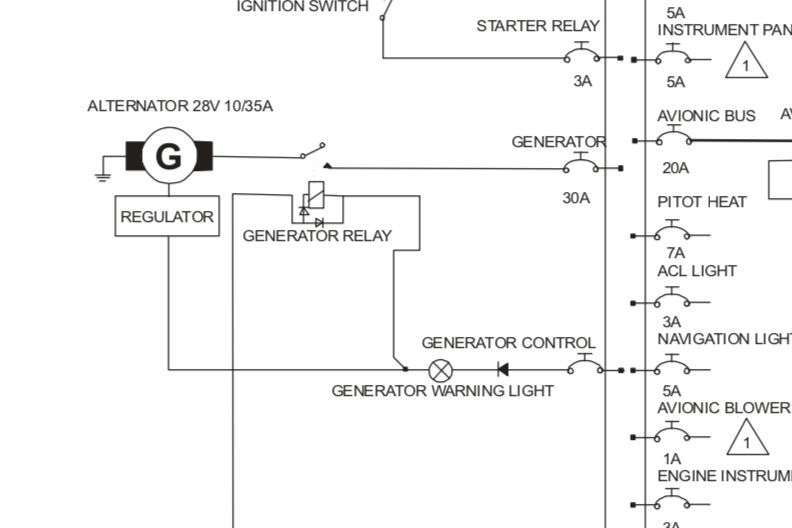

The aircraft charging system is based on a Bosch 28V automotive alternator; I don’t have any technical details of whether it has any inbuilt over-voltage protection. The Approved Flight Manual indicates that an over-voltage condition has to be noticed by the pilot and pilot action is required to take the alternator off-line manually by pulling the c/b. So it’s probable there’s no automatic protection included.
To demonstrate that I’m compliant with 23.1353(d) I’m thinking of including in the modification the installation of a crowbar protection module on the alternator field coil.
So… to get to the question… can anyone suggest a part number/supplier for a 28V OV module (30V trigger voltage)? Ideally one that is already in use on a TC airplane somewhere, which will make it easier to have that part approved as part of the modification.
Or are there any other ways I could provide comfort with respect to 23.1353?

There HAVE been H-O explosions associated with
SVLA batteries. The only two I've been privy
to were (1) an internal explosion on a 44AH
bizjet battery that suffered an open, inter-cell
weld in the top of the battery. The explosion
cracked the case but did not cause damage
to the aircraft.
A second case was in a GlasAir fitted with
a battery box behind the passenger seat. The
battery contactor was inside the box too.
The battery had been subjected to a sustained
ov condition. The pilot was engaged in some
exploratory, switch-flipping diagnostics
that ignited the trapped gasses inside the
battery box and blew it up.
The WORST policy for dealing with an
outgassing battery is to enclose it. The
battery box was originally intended to
conduct SPILLS over overboard. It had
nothing to do with venting of gasses.
The abused SLVA battery is LEAST likely
to provoke a bad day in the cockpit by
strapping it down to an open tray. Any
dangerous gasses that do escape the
battery simply waft away. Explosions
occur when fuel is ignited within a
tightly closed space.
If 'fuel' is generated by an abused battery,
the best prophylactic against explosion
is to let it waft way. It won't explode
or burn even if you ARE a smoker.
Not the point. Proper conduct of FMEA
considers ONLY one failure at a time.
Assume that the battery WILL be abused
as some point in the future. Then eliminate
probability that the failure escalates
into a more excited situation or propagation
out to the rest of the system.
Strap it down in the open air and you're
good to go.
Adding ov protection is called for
by FMEA on the alternator irrespective
of any other components on the aircraft.
For decades, builders and some manufactures
have modified internally regulated alternators
to (1) remove internal regulators and (2)
install legacy regulator/ov protection.
I'll suggest that the confident fast-track
is to do that mod to the alternator and install
a regulator qualified for TC aircraft like
https://tinyurl.com/yb6o5vtn
or for OBAM aircraft
https://tinyurl.com/y9tlkpyo
Depending on your airplane's station in
the aviation hierarchy.
Both of these examples will come with
OV protection . . . the B&C product
also offers OV annunciation.

It is (they are) going to be located under the seat. The airframe is composite, and the seat frame is part of the airframe, forming a well, but the seat top doesn’t seal tight, so let’s assume that that the seat void is adequately ventilated for lighter-than-air gas to the rest of the cabin. Being a modern airframe, the cabin is relatively leak and draught free. The bubble canopy seals well with a rubber cushion all the way around. When the cabin ventilation system is shut off, there are no draughts.
The lower explosive limit for Hydrogen is 4%. Taking a factor of 4 safety, and assuming a cabin volume of 3m^3, a hazardous amount of H2 is 30 litres.
Outgassing from all lead acid batteries during a significant over voltage event is 7.6ml H2 / cell / amp / minute. RG technology works great to reduce outgassing at low charge rates but isn’t a lot of use at high currents.
The alternator is fitted with a 30A breaker. The worst case continuous release of hydrogen would occur when the alternator produces a voltage sufficient to charge the already-charged battery with a current of exactly 30A. Any more and the breaker will trip.
There are 12 cells between the two batteries. That means that the worst case production of H2 is 2.7 litres / minute. A hazardous environment would follow, for regulatory purposes, in approximately 10-15 minutes, assuming no ventilation.
I am *not* permitted to assume that the pilot will take the appropriate corrective action within that period and shut down the alternator. If I want to claim that the level of cabin ventilation is guaranteed to vent hydrogen at a rate sufficient to prevent buildup of 30l of H2 in that sort of time frame, I will have to justify that with adequate data.
Alternatively if there is an over-voltage trip that prevents the bus voltage rising above 32V, then the battery would have to be limiting the overcharging current to less than 4A. The time to a hazardous buildup of H2 in the cabin would be 7.5 times greater, or more than one hour.
At a current of 4A, I can carry out an experiment with the proposed battery and a power supply in the actual aircraft in a hangar, in still air conditions, to measure the cabin H2 concentration rate of rise. (I don’t think I could find a power supply with sufficient voltage overhead to force 30A through a lead acid battery, nor would I feel comfortable doing so.)
Another way to satisfy regulatory requirement is to use a Concorde RG-11M that has a manifold and a vent tube. I can connect the vent tube to the original vent provided for the flooded battery, and the requirement is satisfied because all gas will vent to the outside. The disadvantages are that it’s a lot more expensive than two odyssey batteries. And at 27lbs, harder to mount.
So…> to get to the question…> can anyone suggest a part number/supplier for a 28V OV module (30V trigger voltage)? Ideally one that is already in use on a TC airplane somewhere, which will make it easier to have that part approved as part of the modification.

If one is hard-over with out-gassing
concerns, it's possible to add your
own vent plumbing to most batteries.
A PC-680 has a 'manifold" that just
doesn't happen to have a vent connection
[img]cid:.0[/img]
You could drill a hole though the vent gallery cover
and bond a tube fitting to the lid. Then add length
of Tygon or similar to conduct vented gasses anywhere
else you wished to go . . . perhaps to the
extreme end of the empennage? If there are two batteries,
the tubes could be Y-ed into a single tube for
remote disposal of the gasses. You might add some
robust sealant around the periphery of the gallery
cap . . . E6000 would be good.

PostPosted: Mon Feb 04, 2019 8:04 am    Post subject: Overvoltage protection and other stuff Reply with quote
The certification basis for this aircraft is FAR23 (amendments 1-32 inc.) and that includes:
"23.1351(c)(5) Each generator must have an over-voltage control designed and installed to prevent damage to the electrical system, or to equipment supplied by the electrical system, that could result if that generator were to develop an over-voltage condition."
AC23-17C explains the rationale behind this rule (introduced in 1977) saying
"Explanation. Complete electrical system failures on both single and twin engine aircraft continue to occur. The electrical failure that causes this problem is often the loss of voltage control in the voltage regulator. This usually results in a bus voltage well above the capabilities of the electrical equipment connected to the bus. This overvoltage condition frequently destroys electronic equipment and boils the electrolyte in the battery.”
Bill - you must have first hand knowledge of the introduction of this rule, am I right?
When I look at the circuit diagram for the alternator on this aircraft installation it has the following:
[img]cid:5FA70F90-2701-4C5E-9DB9-BA6469BB8EBB(at)home[/img]
The connection leaving the exerpt at the bottom goes to the master switch. And one of the diodes on the generator relay is (I think) shown reverse connected. But apart from that I can see no overvoltage protection. Does the FAA consider that it is included in the design of the generator? (It’s a BOSCH standard part.)
Any thoughts?
It's a certainty that the system you've
illustrated has no OV protection. It can
be added in the form of a crowbar ov
protection module on the field supply
breaker:
https://tinyurl.com/ya3azjhk
or a DIY project
https://tinyurl.com/joeopsn
or by installing an alternator controller
that features self-contained ov protection.
Here's one set of examples . . .
https://tinyurl.com/y7dscw4y
There are many others.
