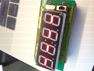

I have designed and built an optical tach for checking prop speed, using a PIC, a photodiode, and a four digit LED display. You point it out of the window through the prop disc as you fly along It’s the size of (and runs from) a pair of AA batteries. You can use it for checking a drill speed too if you put two pieces of silver tape on the chuck.Total part cost is about $7. It shows what you can start to do with a $1 micro controller.
Do you think the list would like it as a build-it-yourself project? It’s a good intro to SMT soldering.

This sounds like a fun DIY project.  I'd like to try it if you don't mind putting together the instructions.  Thanks!
