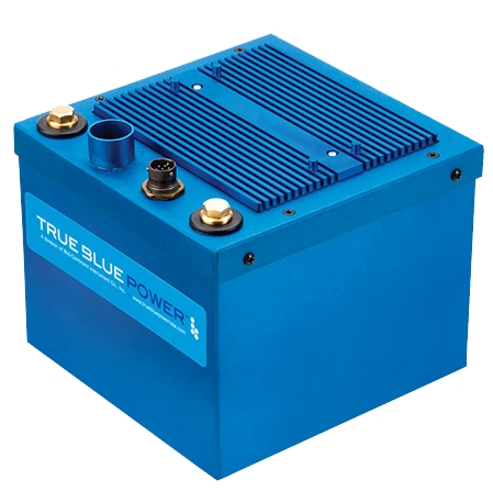

I used to have some friendly contacts at
the Navy's battery testing facilities
in Crane, Indiana. If any battery was
purchased by the Navy, they had put it
through rigorous tests including abuses
designed to produce the greatest risks.
TrueBlue has done extensive testing on
LiFePo4, cylindrical cells used in their
TSO/PMA offerings to TC aircraft. I've
witnessed some tests where a constant
42 volts was placed across the array
of cells in a 24v battery. The poor things
went into apoplectic self-destruction
with considerable out-gassing. Gasses
were vented overboard though the fitting
on top. Outside of the case never reached
temperatures hazardous to the aircraft's
environs.
[img]cid:.0[/img]
I can also tell you that the volume of
electronics in these products is roughly
equal to the volume of batteries . . .
the BMS is specifically tasked with
preventing such a failure in the
first place.
