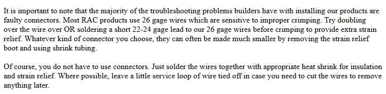

PostPosted: Thu May 30, 2019 10:47 am    Post subject: Aera 660 Bare Wire Cradle Question Reply with quote
At 10:35 AM 5/30/2019, you wrote:
Do you think we could get a petition to these manufacturers that think they're doing someone a favor by shipping products with these "whiskers pretending to be wires" sticking out? (I'm talking to YOU, Ray Allen). Is there any builder that doesn't first have to figure out how to strip those tiny wires without breaking the wires and then find the crimpers to attach a pin to shove into a DB-9 connector? Just stick a stupid female DB connector on the appliance case, because that is what every single person is going to have to do for a maintenance disconnect anyway. There would be so many fewer curse words in my lexicon if this was just standard practice.
Tried that . . . several times . . .
about 20 years. The RayAllen folks
in the booth at OSH just shrugged it
off, "Haven't had any complaints . . .
been do'n it this way for years."
Actually, they're very much AWARE
of the problems as illustrated on their
FAQs page:
[img]cid:.0[/img]
These paragraphs are illustrative of
their intransigence and why I crafted this
ShopNote.
https://tinyurl.com/cmq7epd
 Filesize:  149.11 KB
 Viewed:  28939 Time(s)
