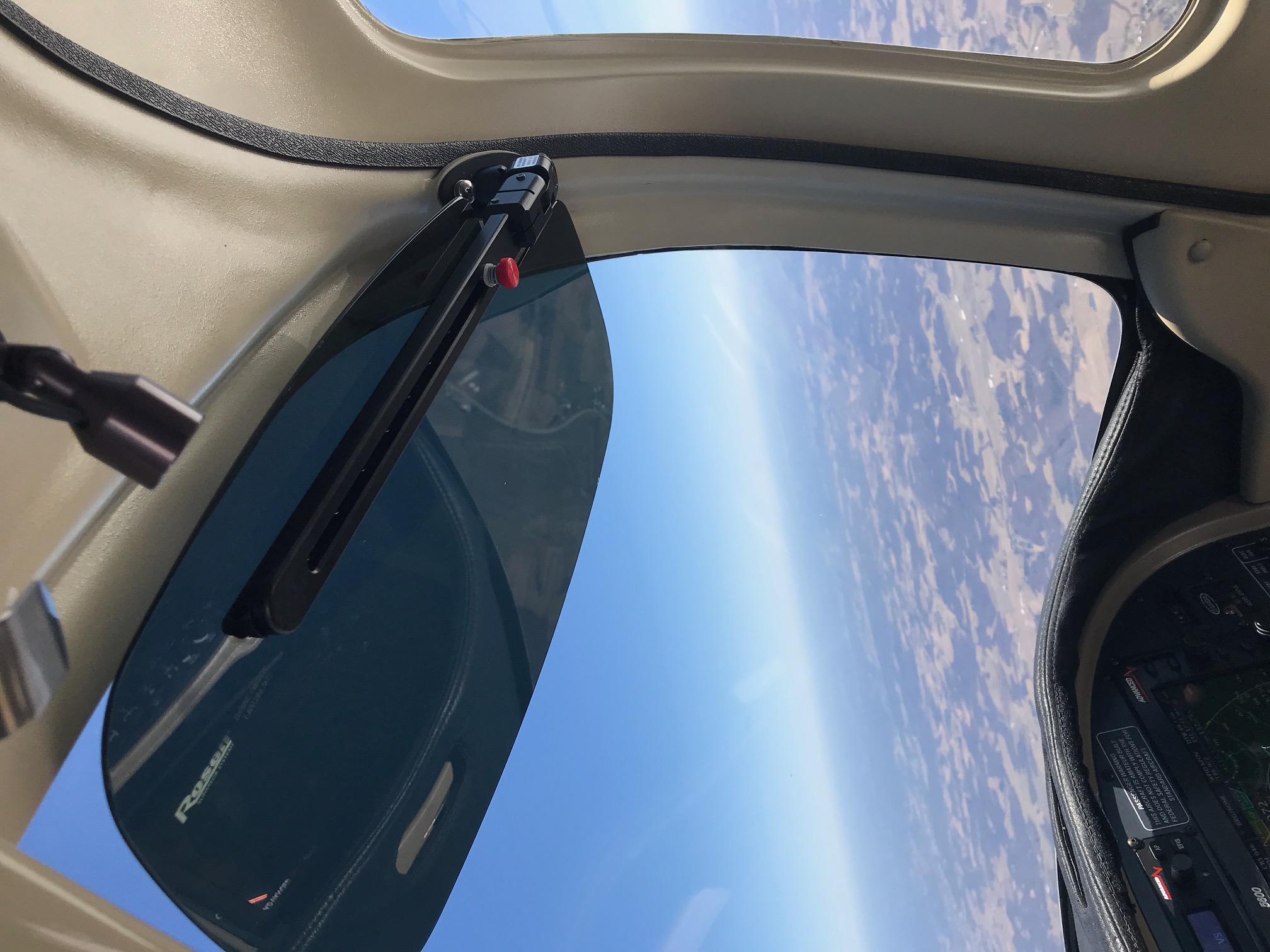

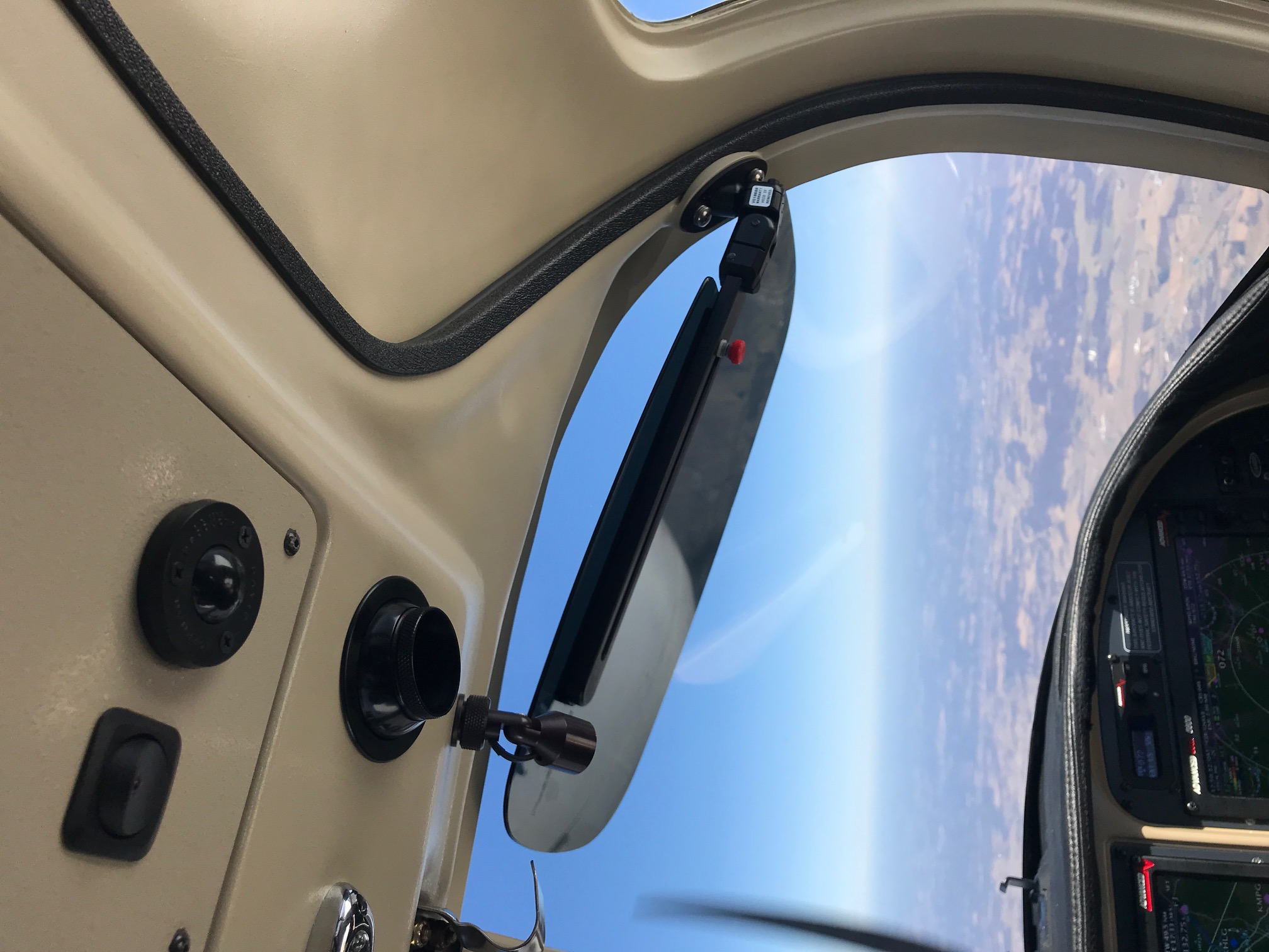

I put in the Rosen visors. They will cover the sun at just about any angle.
Robert Jones

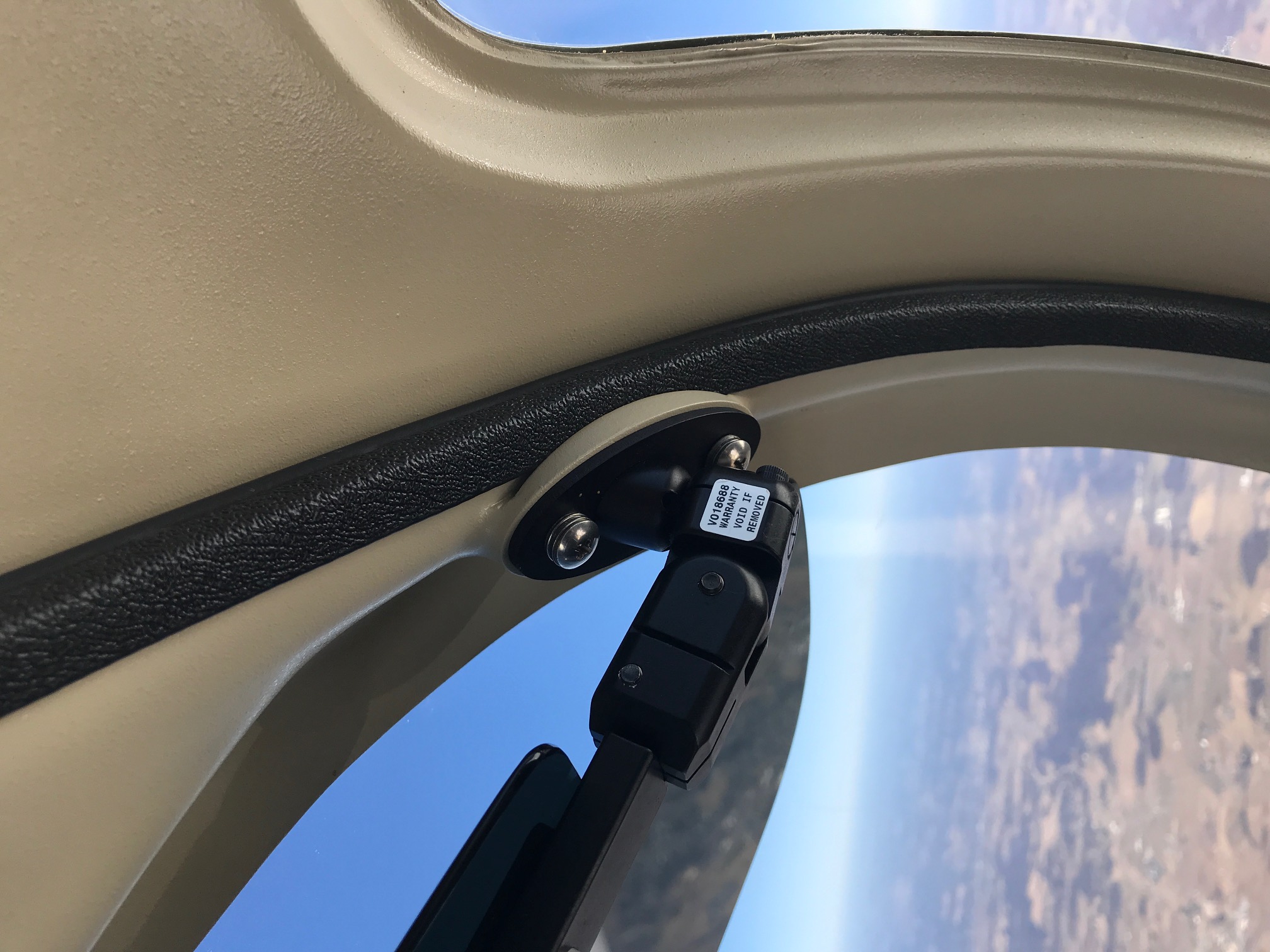

I really like my Rosen visors work on all windows and do not get in the way. I would do it again.
Geoff Combs
